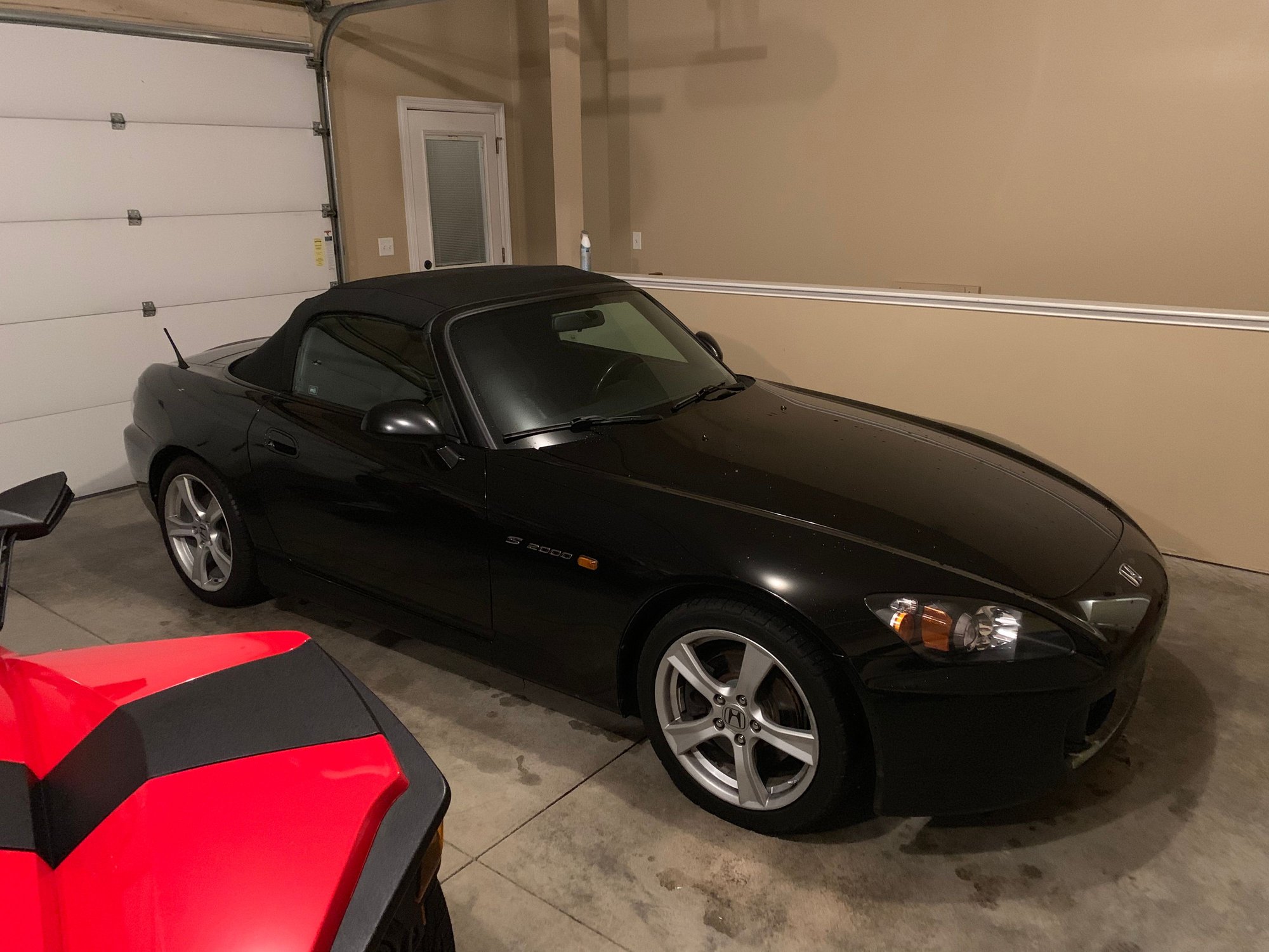

So bought recently 2009 black on black AP2 S2K. Took a gamble and feel I might have lost as the triangle light with exclamation mark (!) was illuminated. Was lead to believe front right abs sensor was reason. Bought a new one and no such luck to have the light go out. THEN today driving normally the VSA light illuminated. I thought I would see if anyone has any guidance before I break down and take it to a dealer. Thanks in advanced to anyone’s input.
