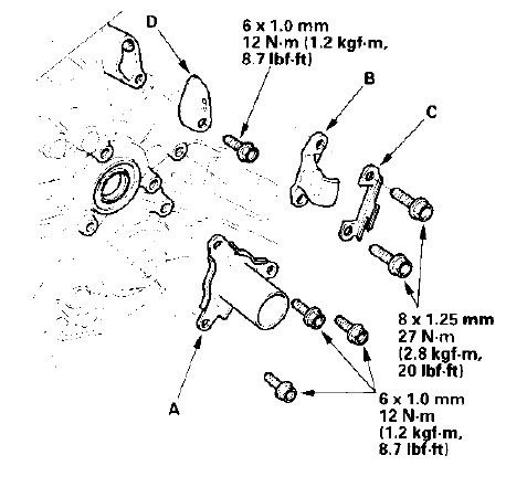

Heys guys
Had a look through the manual, but cant seem to find anything. Does anyone know the torque specs for the three bolts that hold the clutch release guide & also the two bolts that hold the clutch fork bracket & sping clip?
Cheers fellas

Release bearing guide 12Nm and 27Nm for the release hanger spring, it's on page 13-55 in my manual.

I think every 10mm bolt on the car is 8.7ft lbs.
That's true , I think there are a couple bolts that go into aluminum around the valvecover that are down to 7.9 give or take, but for the most part the majority are 8.7.

I just installed the abs cable bracket which use M6 bolt or "10mm" as some seem to call them, those calls for 7.2 ft lbs

Oh and the pressure plate bolts, but those are 12 point.
