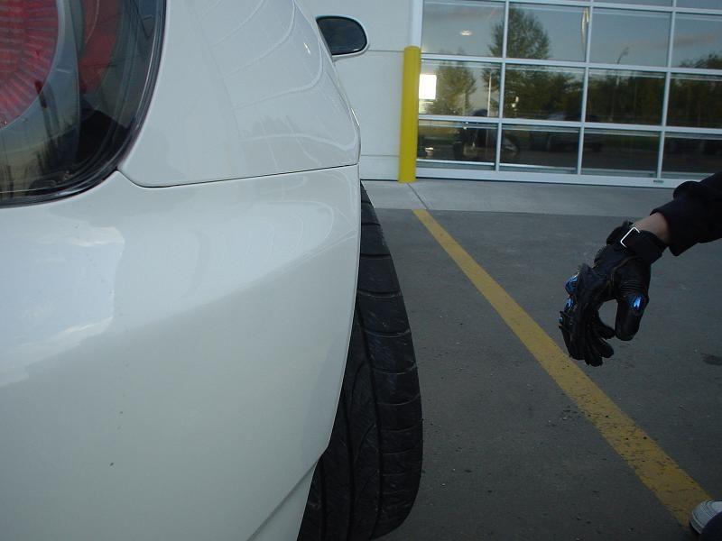

Make sure you have everything checked carefully. I hit my rear passanger wheel at a bit faster than 30 mph and did over $5,000 in damage to the suspension, wheel and exhaust.

Let's hope its okay... mine wasn't driveable...
