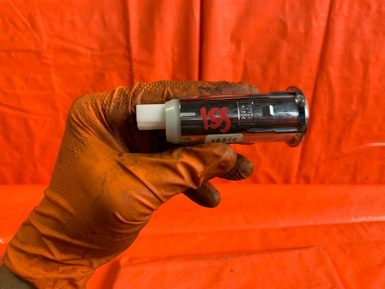

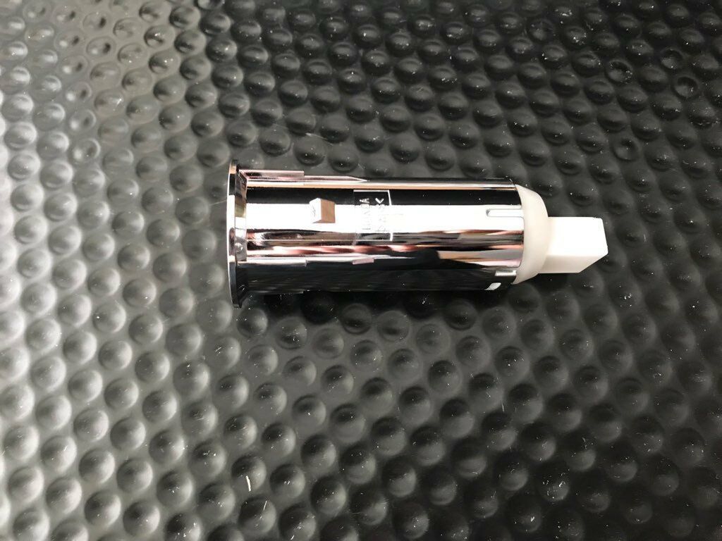

Other side of start button. Metal tab, just push in.
Start button

The circuit board does not need to be removed. There is a round bulb access window on the top of the housing, see last picture.
