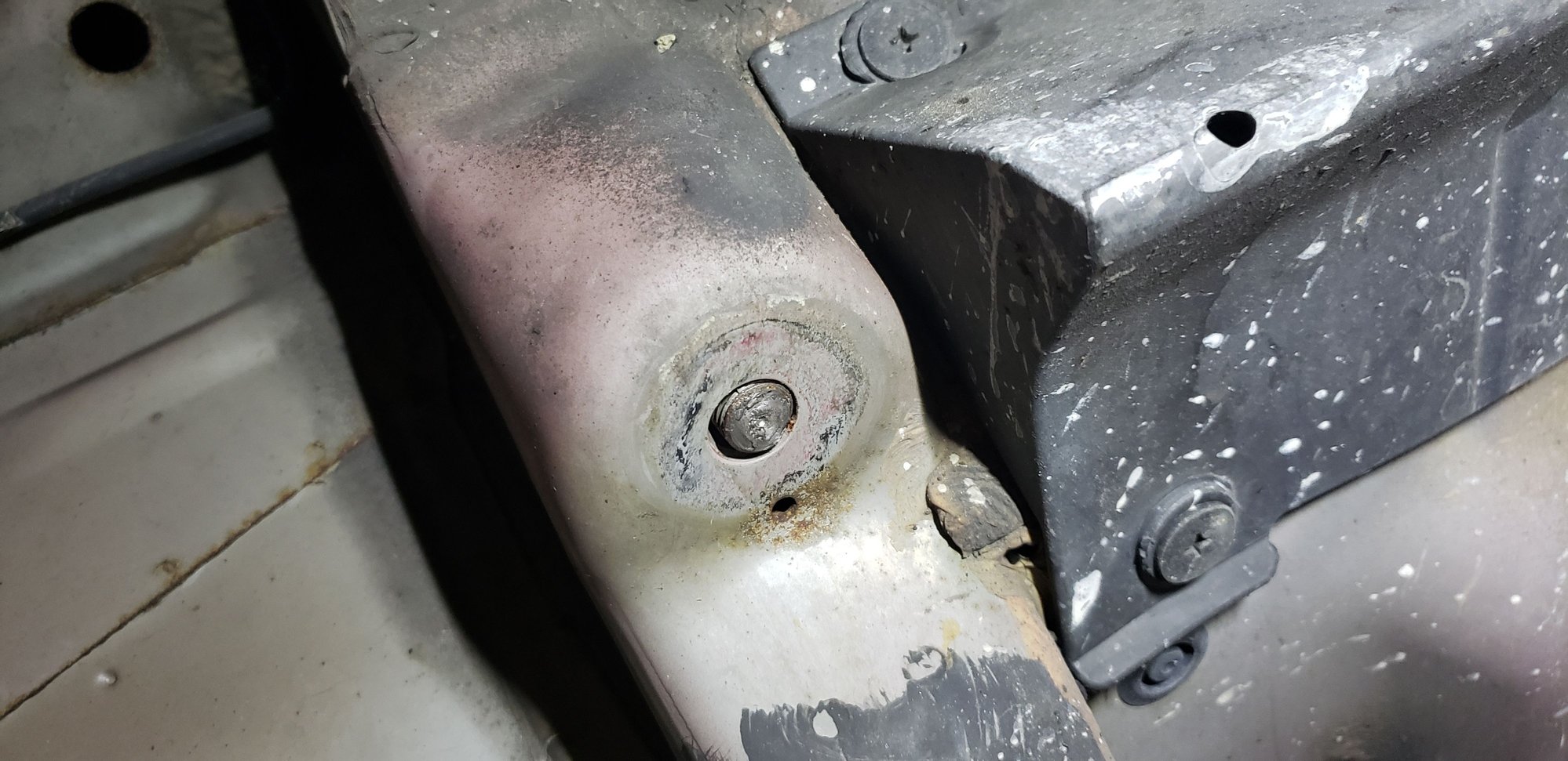

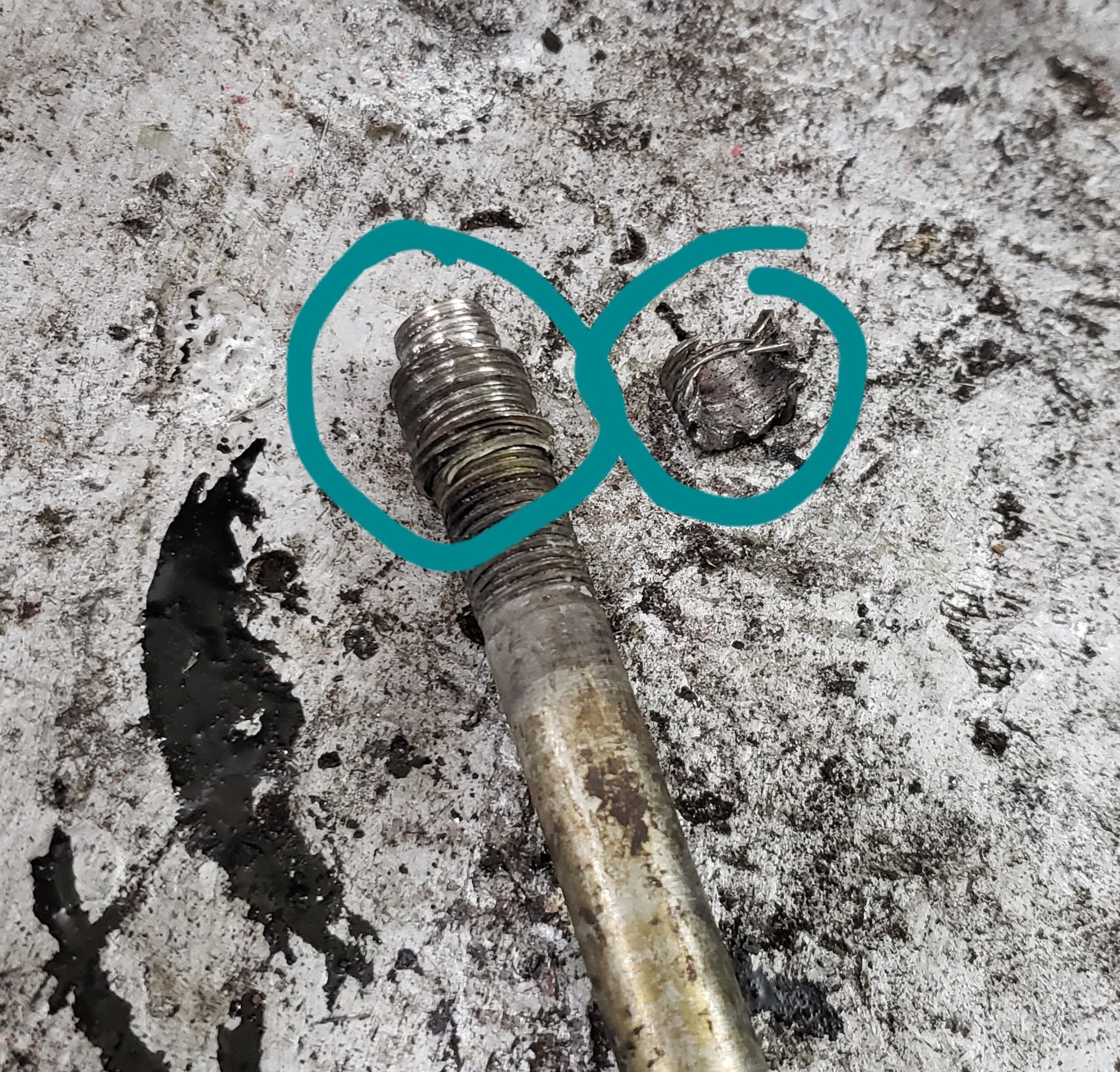

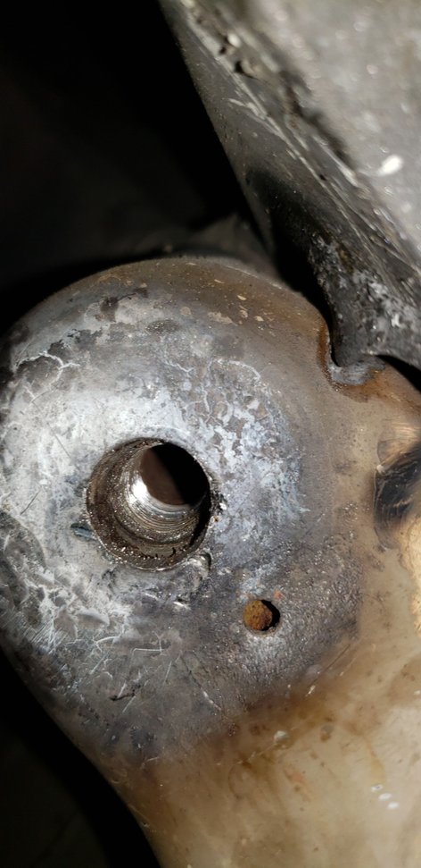

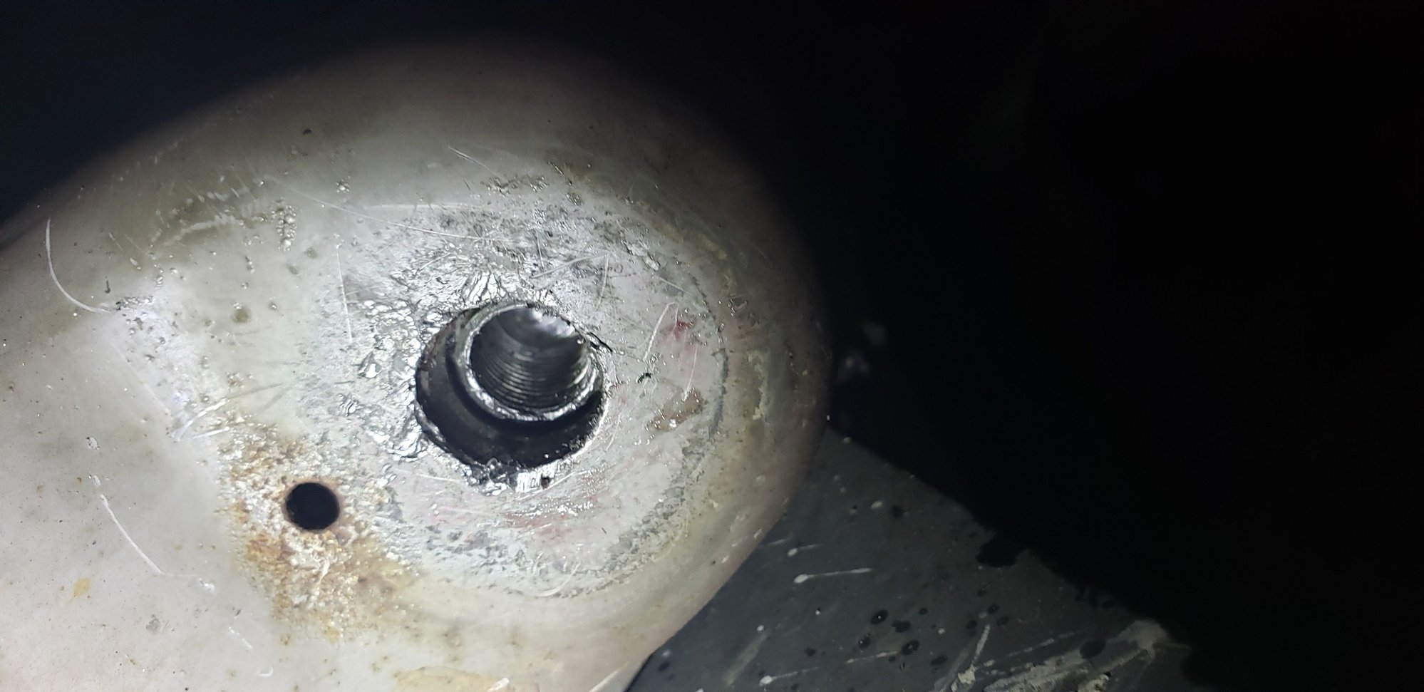

I snapped the rear forward (M14) bolt in my previously winter driven S2000.
I used a powerful IR impact to get it as far as possible. Cycled up and down a few times. Loaded the threads with PB blast via the small holes in the frame.
I had to use a breaker bar and....yeah snapped.
So I drilled it out and invented cunning methods along the way.
I would drill, then tap M12 threads into the bolt cavity and break that section of bolt out by impacting a M12 bolt into there. Since the walls of the receiving thread in the bolt were thin from drilling, it just came out like a sleeve, without hurting the threads.
And I kept going until it was all out.
No damage to my threads on the nut. Just chased it with a tap to make it ultra smooth.
Trick is centering the hole and using a VERY good set of bits. And having MASSIVE upper body endurance....or a lift.
