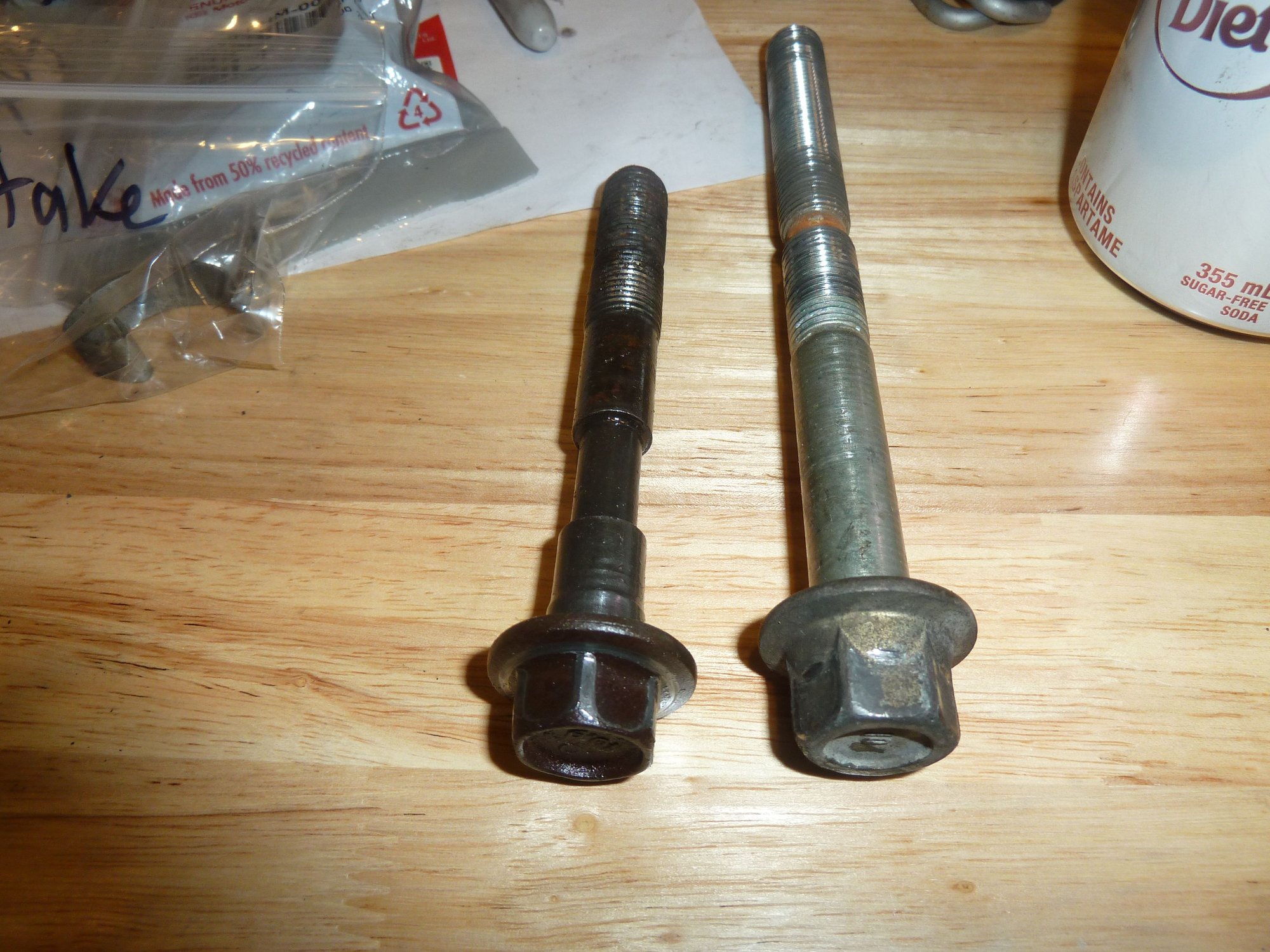

Thank you! This post helped me a lot. We were attempting to do the clutch on our 2001 S2000 and got all the way to the last front subframe bolt and it would only come out 1/4". I got very nervous about breaking the bolt and stopped to do research. This technique worked for me. I kept tightening and loosening and using penetrating oil. Eventually I could get it out with my impact gun safely. Then I discovered it was the wrong bolt.
The one on the left is what came out. The one of the right is what it should have been.
I bought all new bolts for the middle and the front. I think I am going to do the back now too. I started putting the car back together because I thought I would need to take it to a shop. But I think we will keep going now.
Thanks again for sharing this.
I hand threaded back in the new bolt and it went in fine and I was able to torque it to spec. So I think I am good. That incorrect bolt did not seem to damage the threads.
