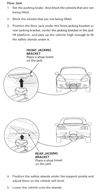

I remember that there was a jack point somewhere underneath the car, in addition to the 4 near the wheels. Can anyone help me find these points? Thanks.

Besides the 4 side ones you already know about, the one in the front is dead center on the cross member that runs under the engine bay. The rear one is actually the bottom of the differential. It is suggested that you put a rag under these jacking points to avoid slippage or damage to those pieces. You may have to drive the car up onto 4 little pieces of 2 X 10 so you can get the jack under there.

Sorry to bring up an old link. Are these "Honda approved" jack points? Did this picture come from the Helms manual?

Yes they are Honda approved jack points. Get a Helms Manual.
