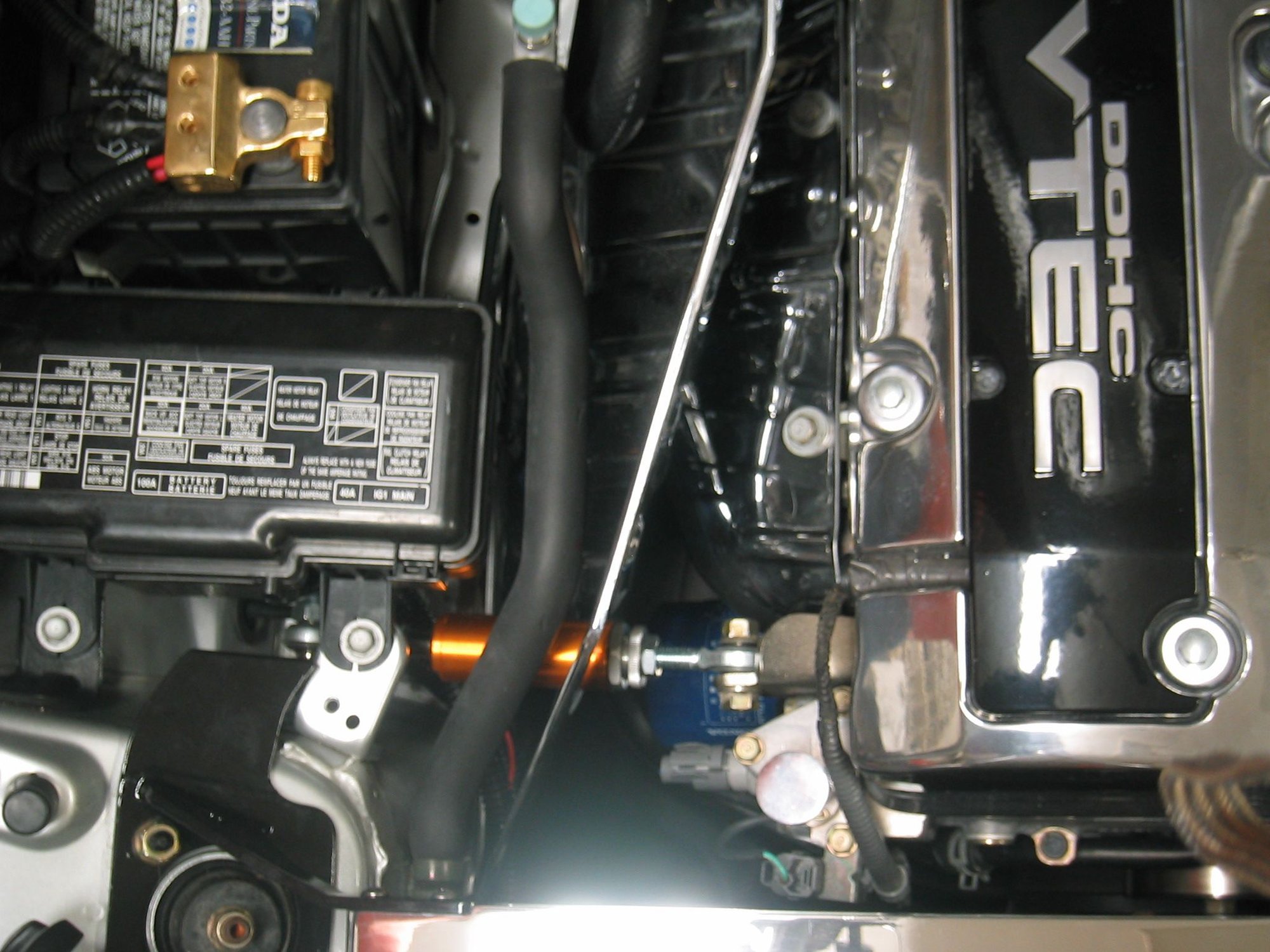

No, you don't remove anything from the motor. There is a threaded hole just to the left. The supplied bolt goes into that location and holds bracket in place. The damper mounts to the bracket and to the STB mount.
Now you do have to cut the Fuse box mount from the car. That is why Iu had a custom mount made. I hate to cut anything.

how hard is it to cut the fuse box mounting? what did you make to avoid cutting it?
Old Nov 24, 2004 | 10:32 PM
kane.s2k's Avatar
Joined: Aug 2003
Posts: 5,372
From: The Beach, CA
He told you what he made. Read his post and look at the picture.
