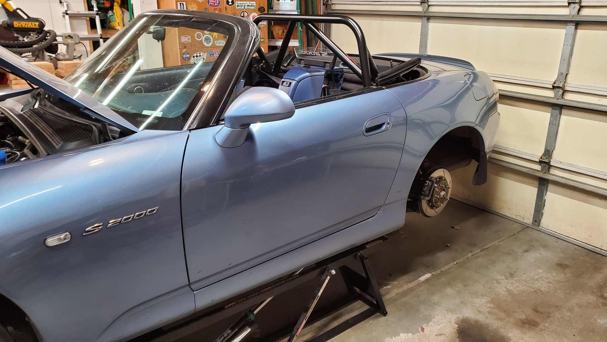

1) I have always left the hydraulic unit on the ground. No issues. Make sure the vent is open when you are using it or it may damage the unit.
2) In that paragraph I beleive the Quickjacks are the properly rated jackstands they are referencing. Seems more of a disclaimer to always lift at the prescribed jacking points.
Also remember, the Quickjack only uses the hydraulics to raise and lower the car. When you are working on the car the load is supported on the frame stops.
I will add that I recently installed a roll bar in my car which requires removing the rear wheels to access the wheel well. While the car was jacked up I went in and out of it a hundred times. Not sure I would have wanted to do that on regular jackstands.

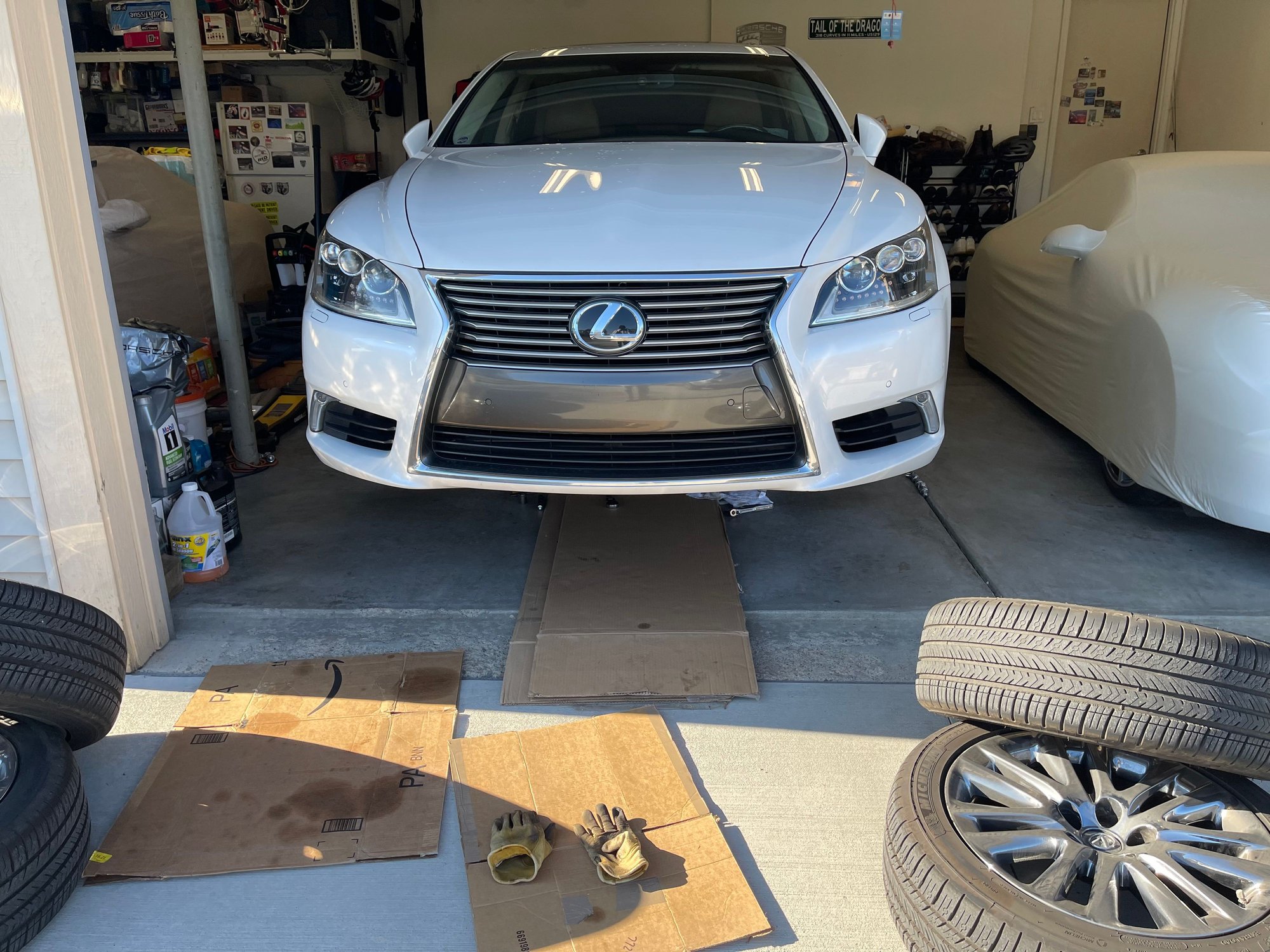

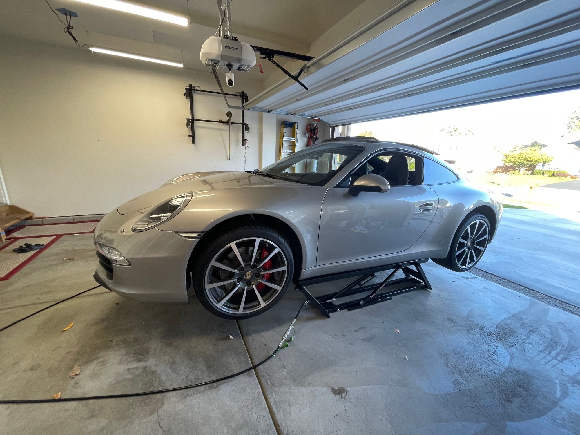

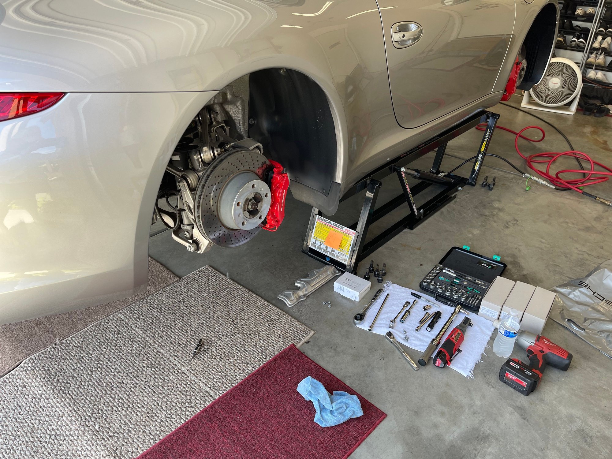

I just used the regular blocks. Avoid stacking the blocks if possible, it will be more stable. I will also have jack stands under the vehicle if I am under the vehicle, just an insurance policy. Here's a few pictures of the jack being used on the C2S and LS460.
C2S on Quickjack
C2S Spark plugs replacement
LS460 Trans. fluid drain/fill.
