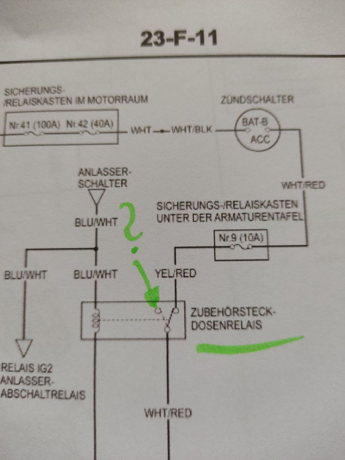

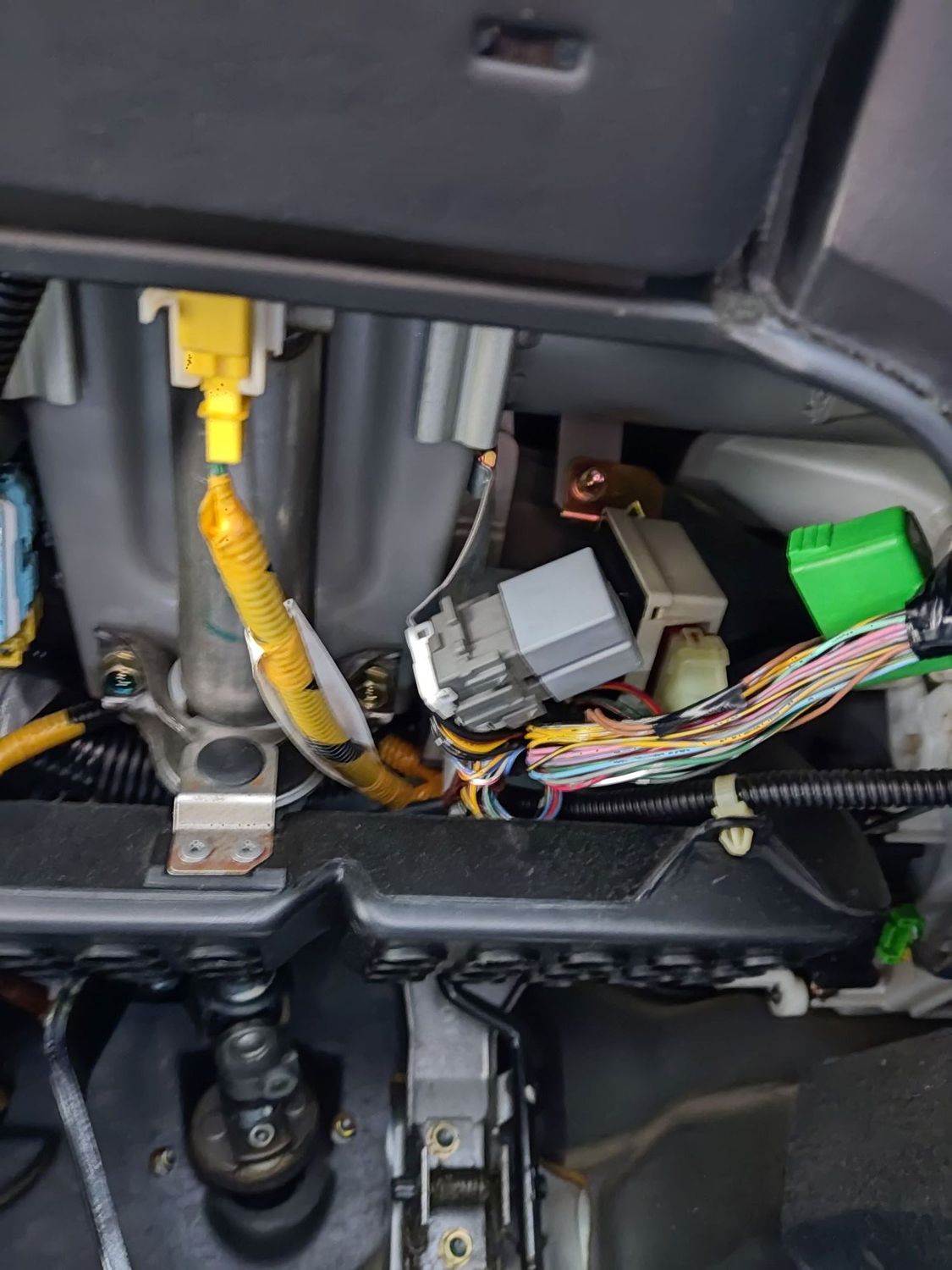

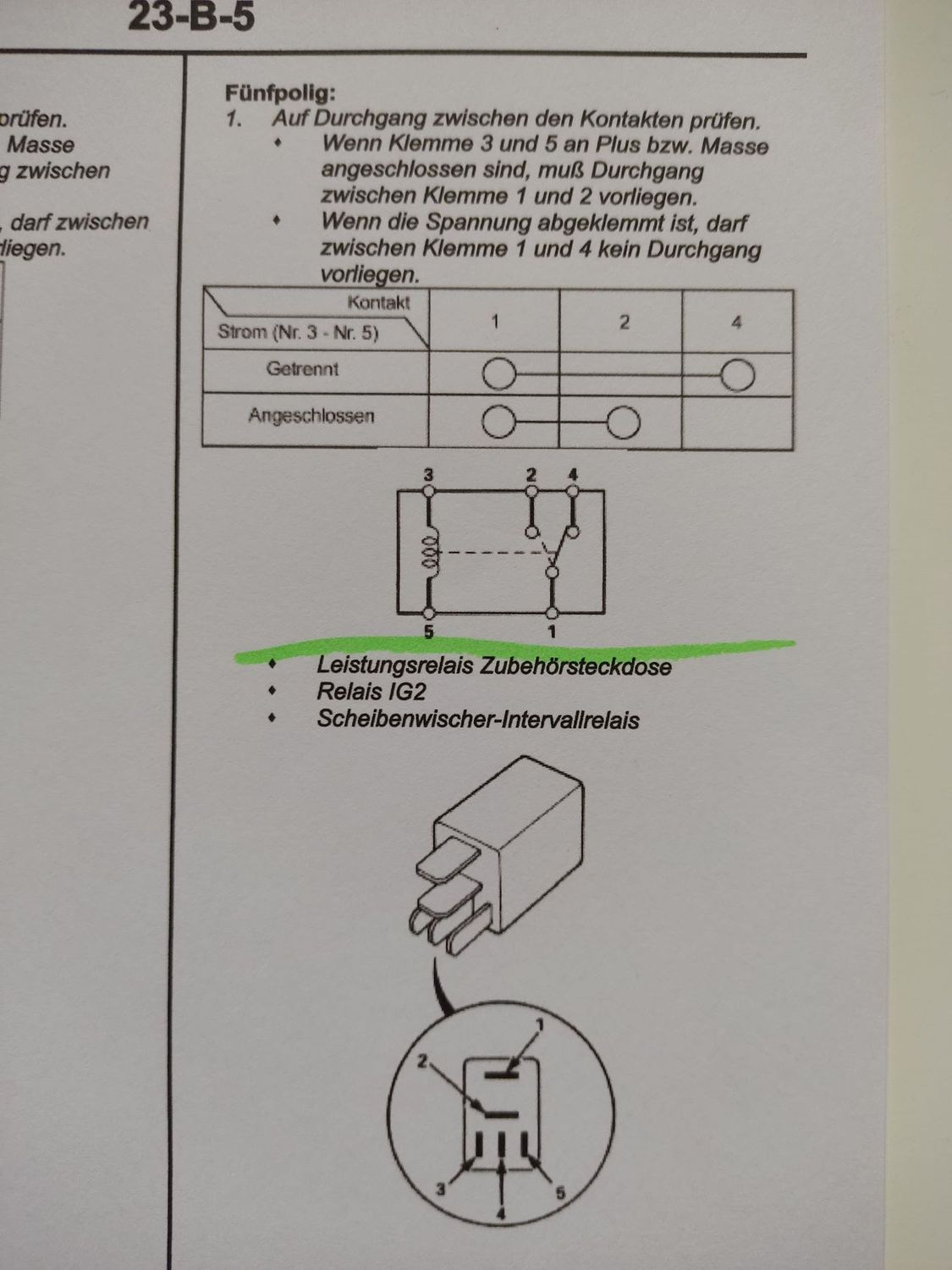

After studing the US and the German OEM Honda Workshop manual, i found out that my Euro / German version has a grey coloured 5 terminal relay for the power plug and stereo. But the 5. terminal is unused... .. makes no sense. Maybe they where cheaper.
However, it was easy to replace. It sits direct above the right leg. You could change it sitting behind the wheel, just grab under the dash, feel it and pull it. I replaced it with a high quality relay from Panasonic, rated 35 Ampere, for a few euros.
Done. Lesson learned: Sometimes electronics differ even in basic things between US and Euro versions.
