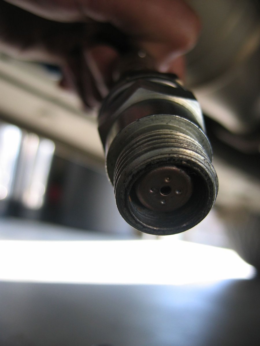

New o2 sensor:
Bad 02 sensor
Bad Catalytic Converter

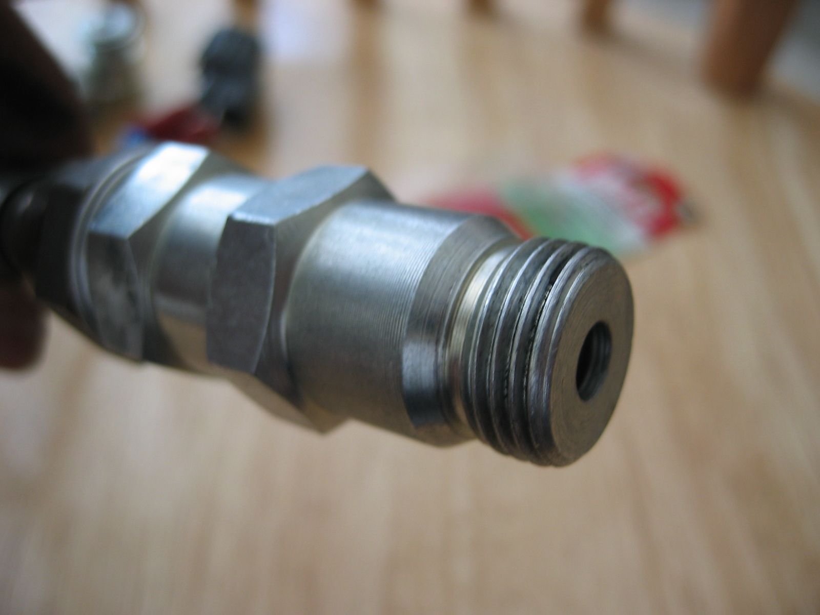

modified spark plug fouler vs. stock
I used a drill press and worked my way up to 1/2'' bit. cuz my bits sucked.
using 1 spark plug fouler
Assembled mechanical 02 simulator

Hecash: I tried your method w/ the 02 sensor, and it didn't work for me. I did everything using the stock 02 sensor harness and splicing in the new 02 sensor using that part number. I think that method works for the primary 02 sensor, b/c I'm still getting a cel: p0141.
I'm probably just going to order the oem one instead. I haven't installed a testpipe, b/c it's still coming in the mail. I just wanted to post some pictures to clear up some things. So, i'll post again once i get that installed and get a new 02 sensor.
xing fingers....
PJ.

Swt, The Primary and Secondary 02's have different resistance values for each heater. That's the biggest reason you can't swap them. Did you use a secondary 02 spliced in?
