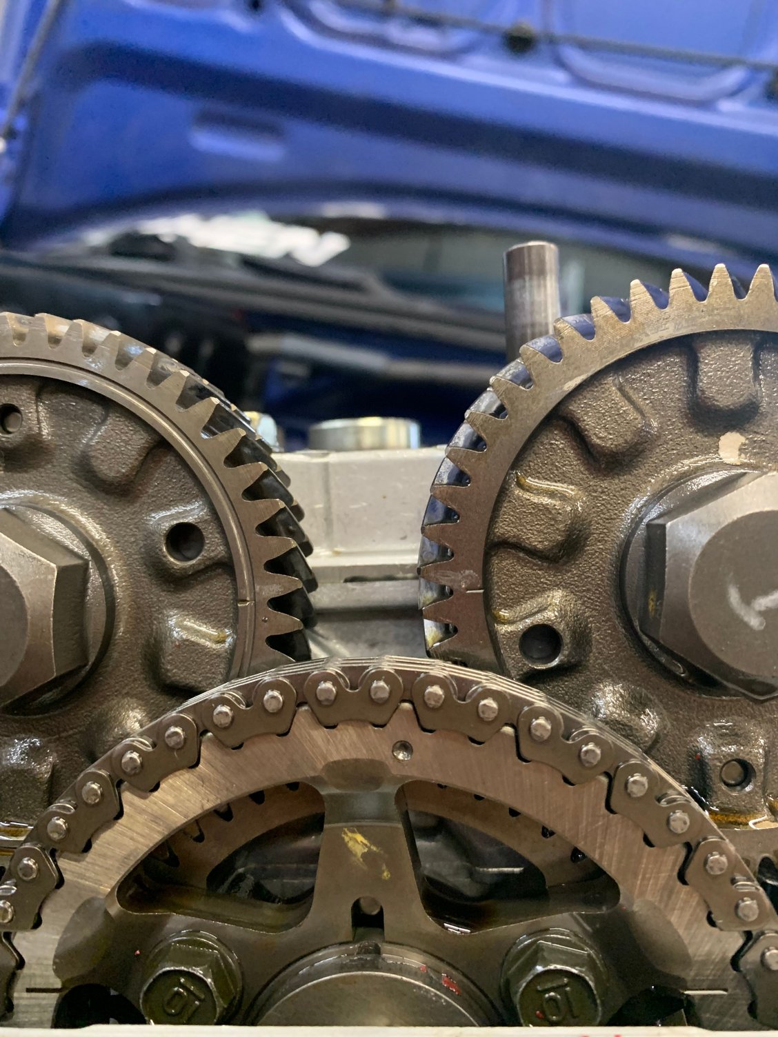

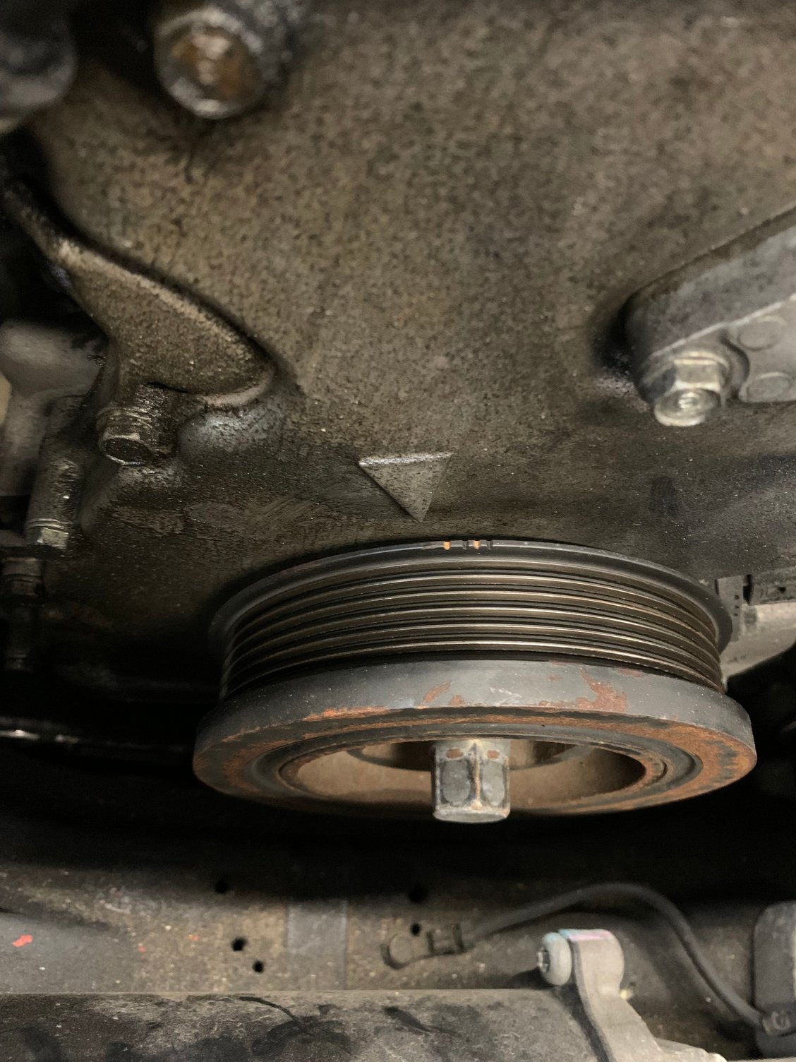

My cans are misaligned when the crank is at TDC

the car is registered in KY so smog isn’t an issue for me. I’ve attached photos of the crank and cams, is this off or normal?

A good way is to test for tdc of piston <remove spark plug ect> and check there.
crank pulley can have some movement wear as its rubber
