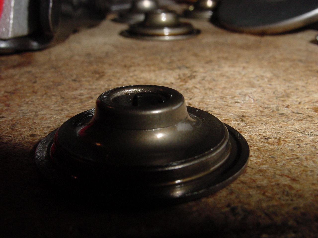

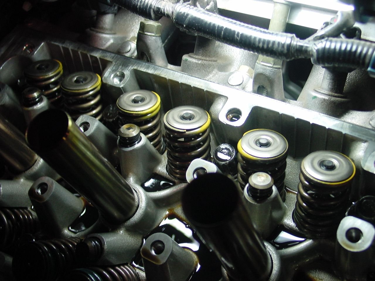

Had an 00 s2k out here Saturday for the once over. First thing I always do is get the valve cover off and check for cracked retainers. Sure enough, I find recessed keepers. This is the 6th S2000 I have found with cracked retainers during routine maintenence.
At this point I skip the entire once over, and fix the engine while the guy waits. F22C retainers and keepers on the intake side only. Re-did the VA that honda did. I'll have the guy post the dealer, NEVER go there for a VA. Half had loose locknuts, all clearances were tight and loose.
-Car has about 40k miles
-guy is the 2nd owner
-car was purchased from a Honda employee who likely demoed the car and used it for test drives.
-the owner is confident he has never mechanically over-reved, but I'm pretty sure the car was over-reved by the first owner.
First pic, little blurry. Serverely broken retainer on left, slightly broken on right.
F22C retainers installed (USA 2.2L)
Here's the kicker. check out the crack on this retainer. It is split circumferentially. This is the first time I've seen this type of crack. This engine was days from coming apart. This type of crack will not show a recessed keeper. However, I'm pretty confident it will only be found in conjunction with the type of cracked retainers we are familiar with.

Actually, the normal cracks are radial. That one is circumferential.
I'm sure this is something that gets easier with practice and skill, but what you seem to be able to do in a few minutes took me hours and hours of work. I wish you lived closer to me -- this is definitely a job I would pay someone else to do if I trusted them to do it right.

I'm assuming the 2.2L retainers are a little stronger then the 2.0L ones?
Old Apr 23, 2007 | 03:48 PM
Billman250's Avatar
Active Streak: 30 Days
Active Streak: 120 Days
Top Answer: 1
Posts: 22,386
Likes: 1,837
From: Long Island, New York
Correct.

Originally Posted by ChefJ,Apr 23 2007, 04:57 PM
How much is a set of retainers??
http://www.hondaautomotiveparts.com/auto/j...PartsSearch.jsp
A couple bucks per retainer. The cost is in the labor.
