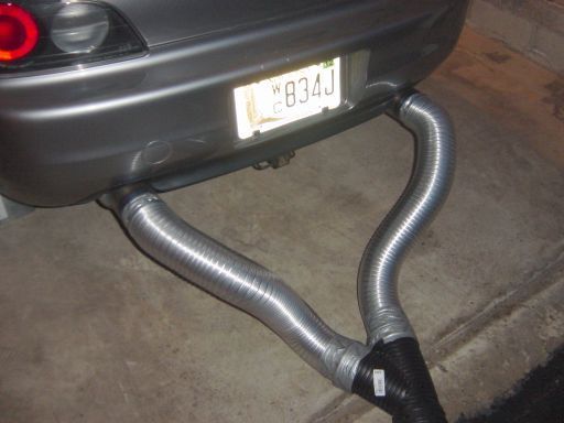

In my quest to stop breathing fumes while setting up the start/idle etc. of the EMS, I took a trip to the Home Despot and picked up about $30 in parts to vent the garage
It uses 2 butted 4" flanges that fit nicely in the 4" spugen exhaust tips (I used 4 1/2" hose clamps to seal the holes in the back part of the tip - I assume they are used to fit a silencer..)
Off of the flanges, flexible aluminum dryer vent connected to a heavy-duty plastic "Y" connector (with prodigious amounts of duct tape) and finally connected 2 8' sections drainage pipes that you can see in the second photo.
Took about 1/2 hour to put together.
The "Y" connector is easily strong enough to support my garage door, and I can always build a baffle for it if later on if I want to "fully" seal the garage . . .

Very nice. Its amazing how even with the garage door open it only takes a minute or to to get gased out.
