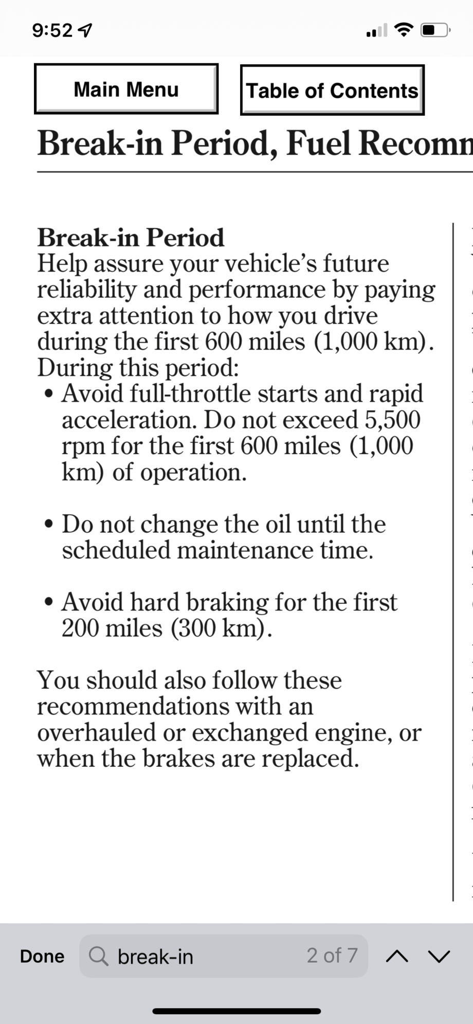

Installed the engine yesterday. Working on installing the transmission today.
For the break-in for this new short block. This is the only information I found on break-in procedure from the factory manual.
For initial start-up, do I run break-in oil specifically or will any conventional dino oil be good? I plan to use break-in oil until operating temp, then flush and fill with a conventional oil.

Startup:
-remove spark plugs
-disconnect injectors
-crank the engine over until the red oil light turns off
-reassemble and start engine
Old Nov 6, 2022 | 01:54 PM
  #50
S2KeptSimple's Avatar
Joined: Oct 2016
Posts: 34
Likes: 10
Originally Posted by Billman250
Startup:
-remove spark plugs
@Billman250 yes that’s the plan. Thank you.
Everything all buttoned up, just need to find the right oil for initial startup and break in
