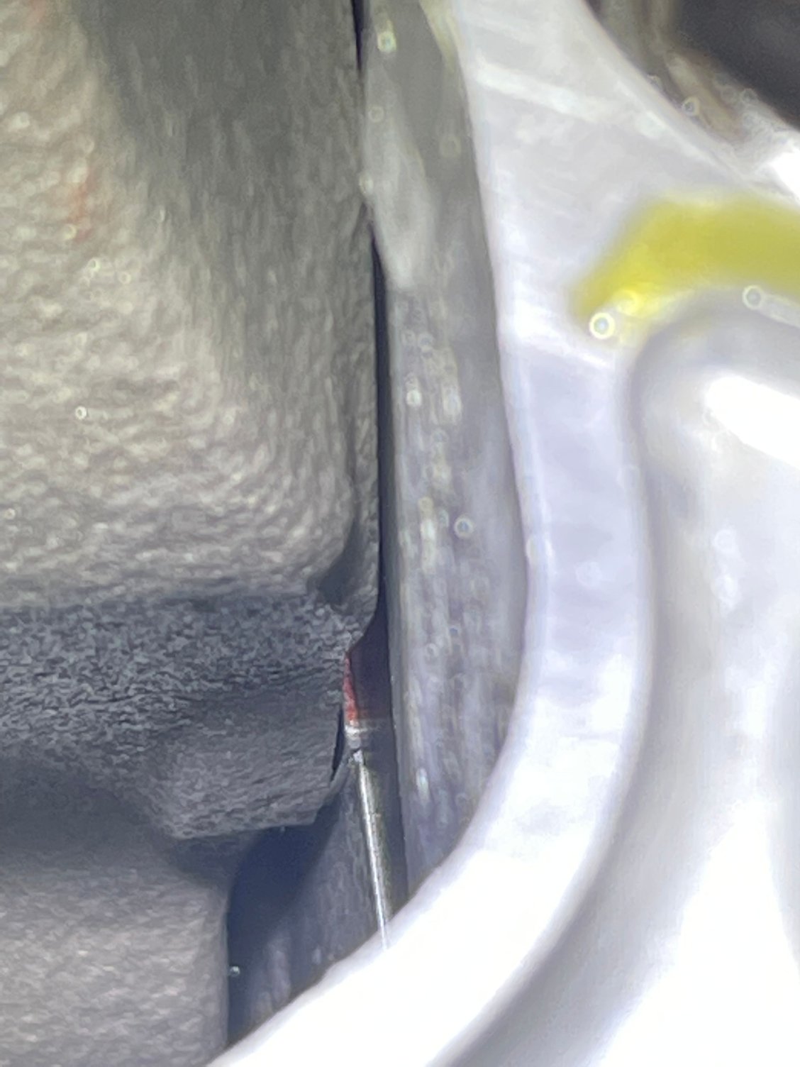

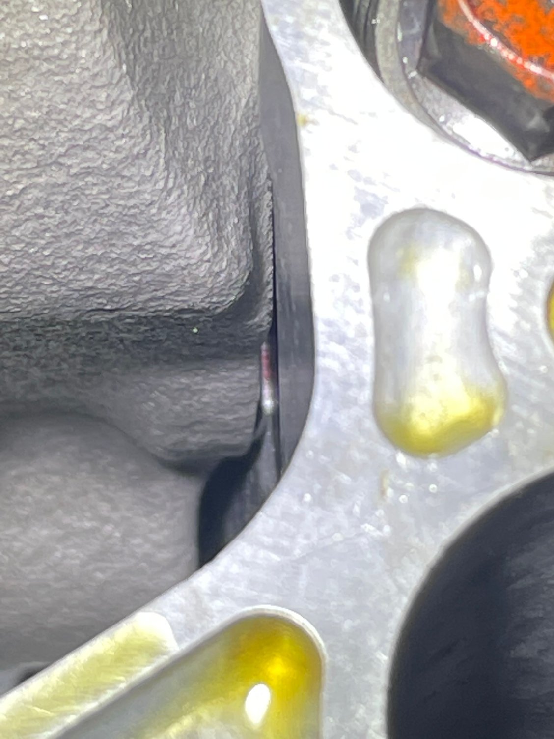

Originally Posted by BuggyofMildDiscomfort
Yea you should be able to see that even without an disassembly
@BuggyofMildDiscomfort your guidance is much appreciated. You saved me from tearing apart a factory shortblock.
From what I can see, yes the orientation of the thrustwasher is correct.
