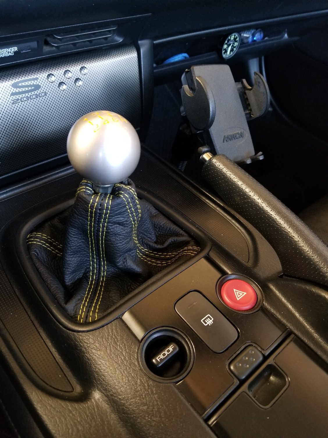

Which "AP2" center console are you referring to? I'm assuming '04-'05 since my '06 has the defroster switch right there making the wiring easily accessible.
Wiring can be as simple as an On-Off toggle. The OEM defogger automatically shuts down in 15 minutes but unless that circuitry is part of the switch or relay you'll probably have to extinguish it manually on a '00-'01 car.

Unless you stumble onto a '06 or later full console you're probably out of luck for the switch panel and it wasn't made in silver that I can see. The 3-switch panel fits the 2006-2009 S2000 "AP2 (DBW)" cars but only seems to have been made in Satin Black (which is what mine looks like). When it was available (past tense) it retailed for $187.77 (!) and I think that's just the panel, not all the switches. The DBW cars have the VSA switch on the dashboard in lieu of the rear defroster switch of the earlier cars.
Honda 83403-S2A-G51ZC Panel, Center Console Switch *NH646L* (SATIN BLACK)
The MY 2000 owners manual does not show a switch on the instrument panel where the defroster is on the 2002 and later -- but if there is a blank a switch may fit.
