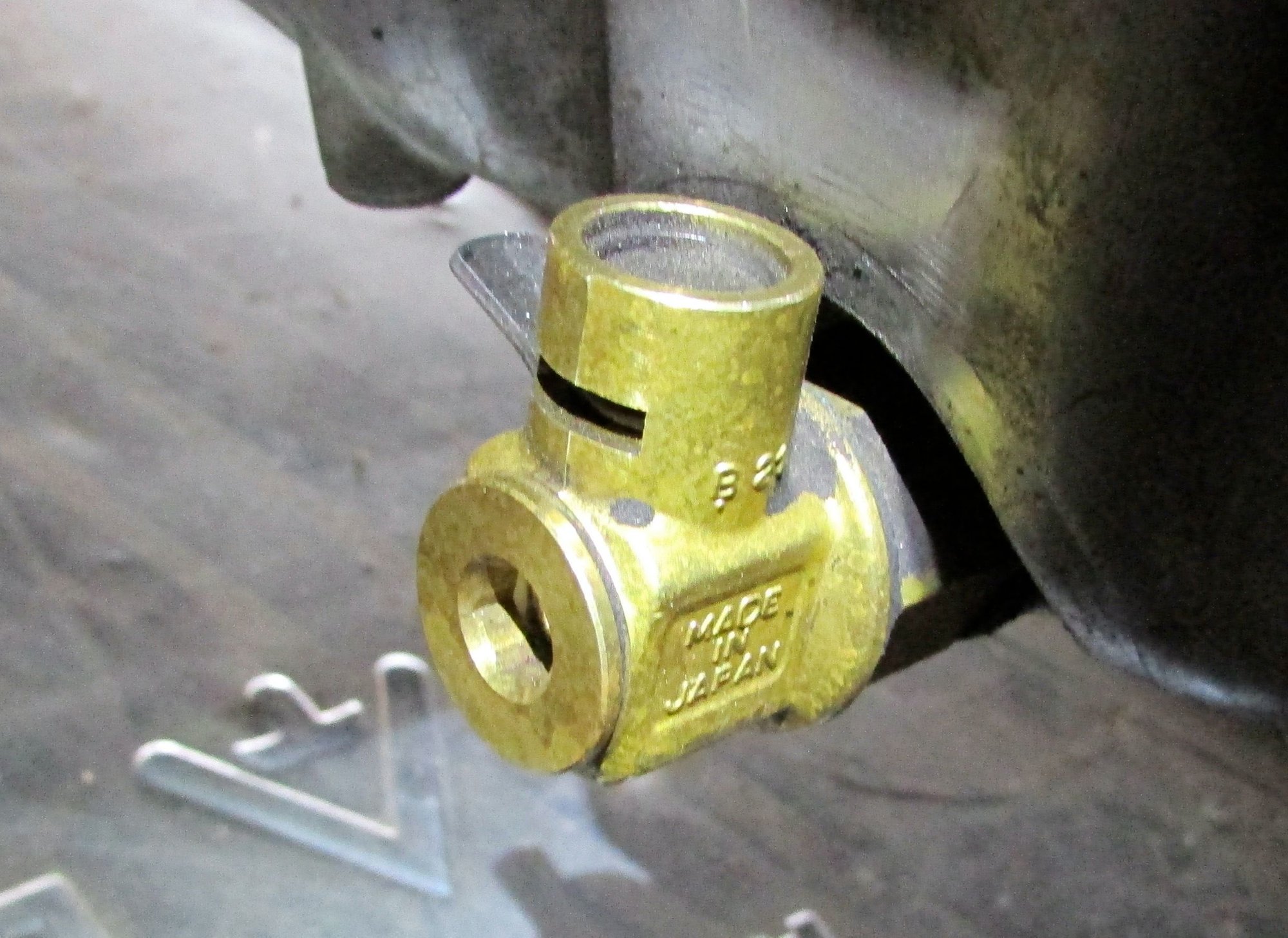

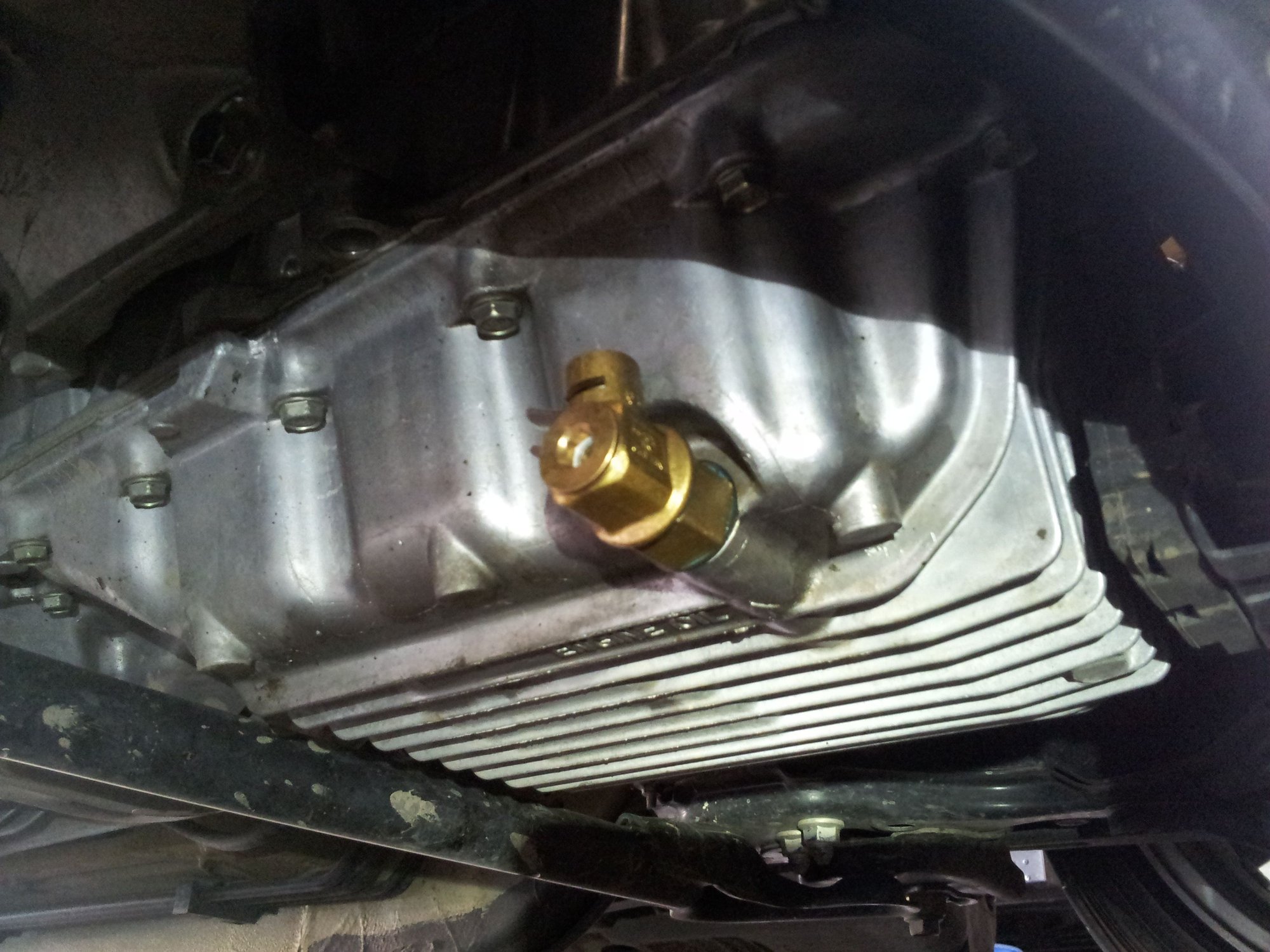

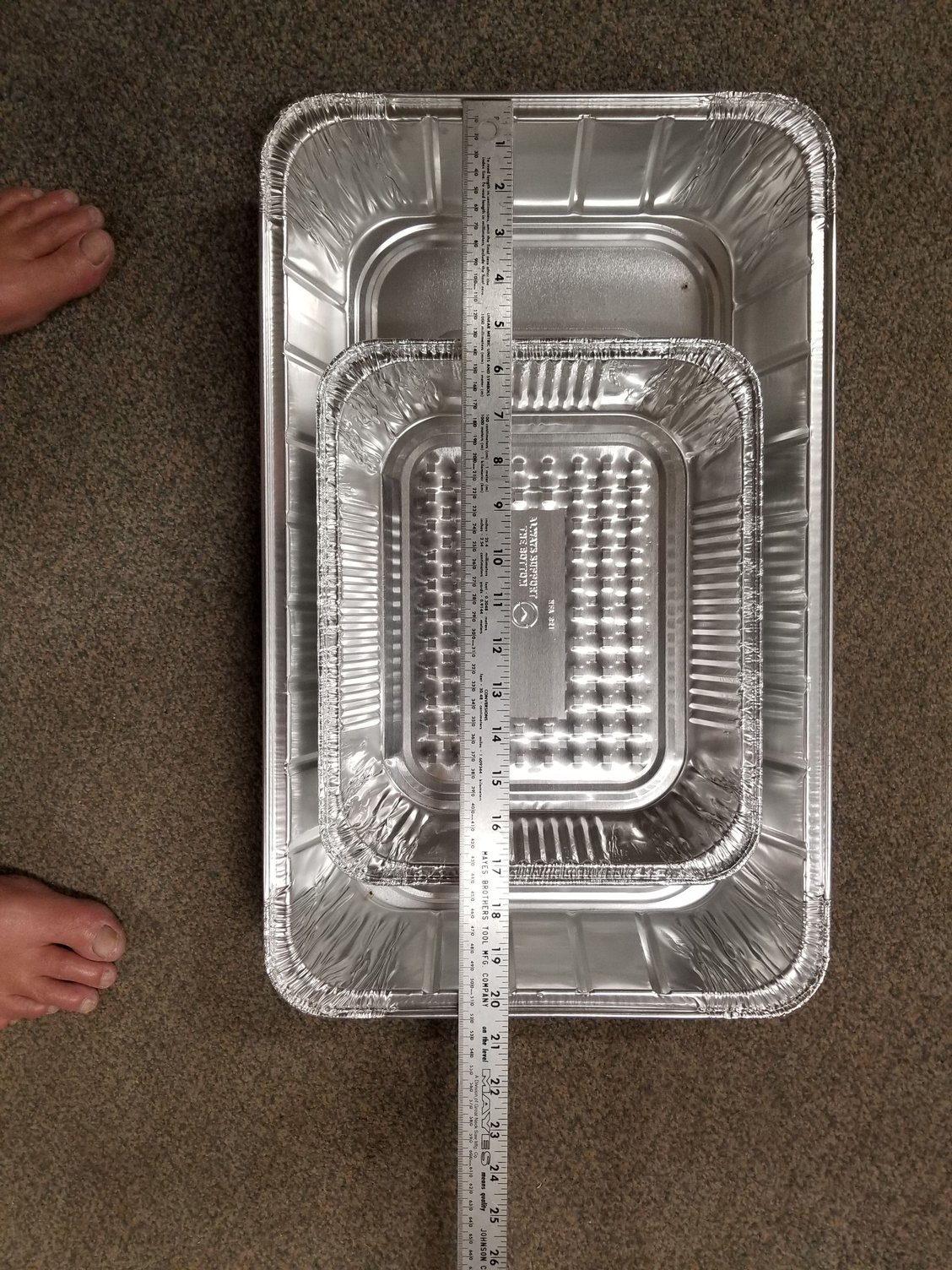

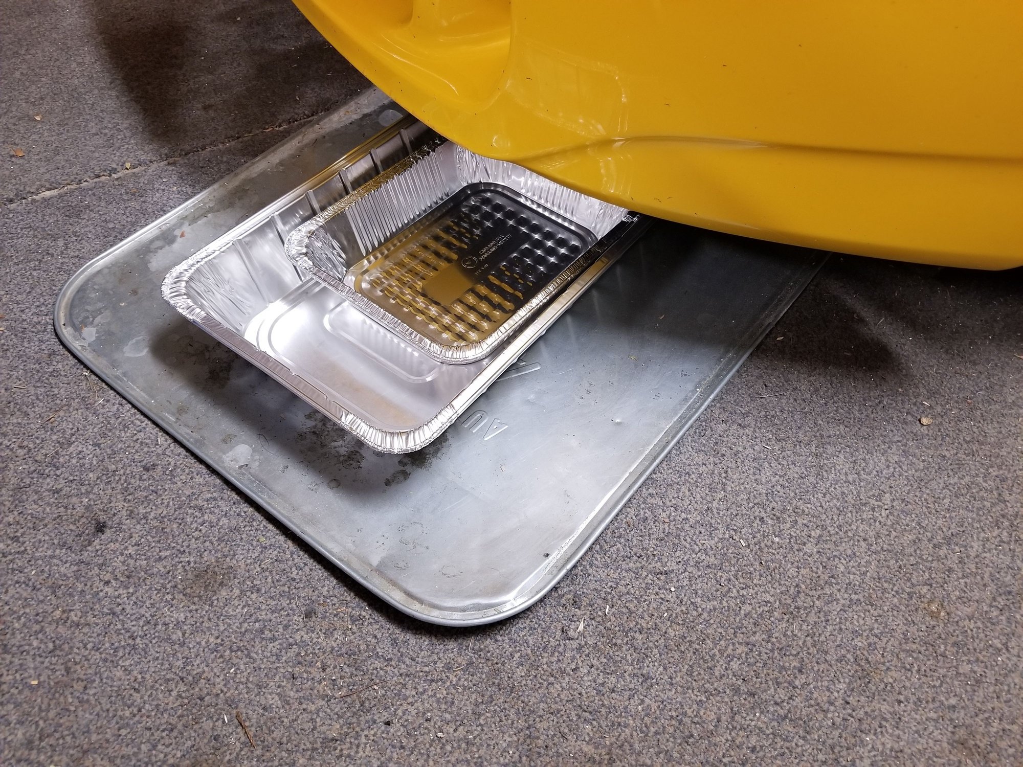

I perform an oil change with just the hood open. I slide a metal drip sheet with an aluminum chafing dish (Thank you Costco) to catch the oil. I installed a Fumoto Japanese oil drain years ago so I can precisely meter the oil discharge. If you are taking a sample for oil analysis, nothing could be easier and cleaner. Nothing to unbolt or bolt. The oil filter can be removed and installed through the open hood.
Easy. I change every year or 3000 miles.
