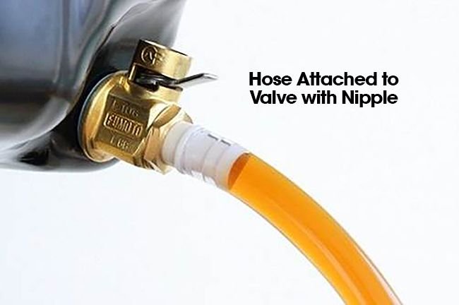

You are forgetting that you don't use a Fumoto and therefore cannot control the oil coming out of the pan. The newer Fumoto (millions and millions of Japanese quality valves proven) have nipples for hoses to deliver oil right into a container of choice. You are correct the aluminum pans can be full and tricky when full but with the Fumoto you don't have to go that far. You just stop the flow and empty the pan at your leisure. Can't do that with a bolt. You can fill your oil sample to the exact amount and just turn the spout off. The newer Fumotos have an additional lock snapping in place to ease the anxiety of those like you who fret unnecessarily.
As far as getting the oil into a container suitable for recycling, I use a previously used 5 quart oil container with a novel engineering device called a giant "funnel" to get the errant oil from the aluminum pan to the oil container.

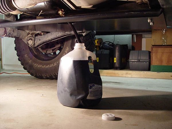

I like that. Instead of buying a new stock oil sump plug just buy this Fumoto valve. Like you, I use an empty 5L oil container and decant oil from the container I use for oil changes to it. Then I take that full oil can/s for recycling.
