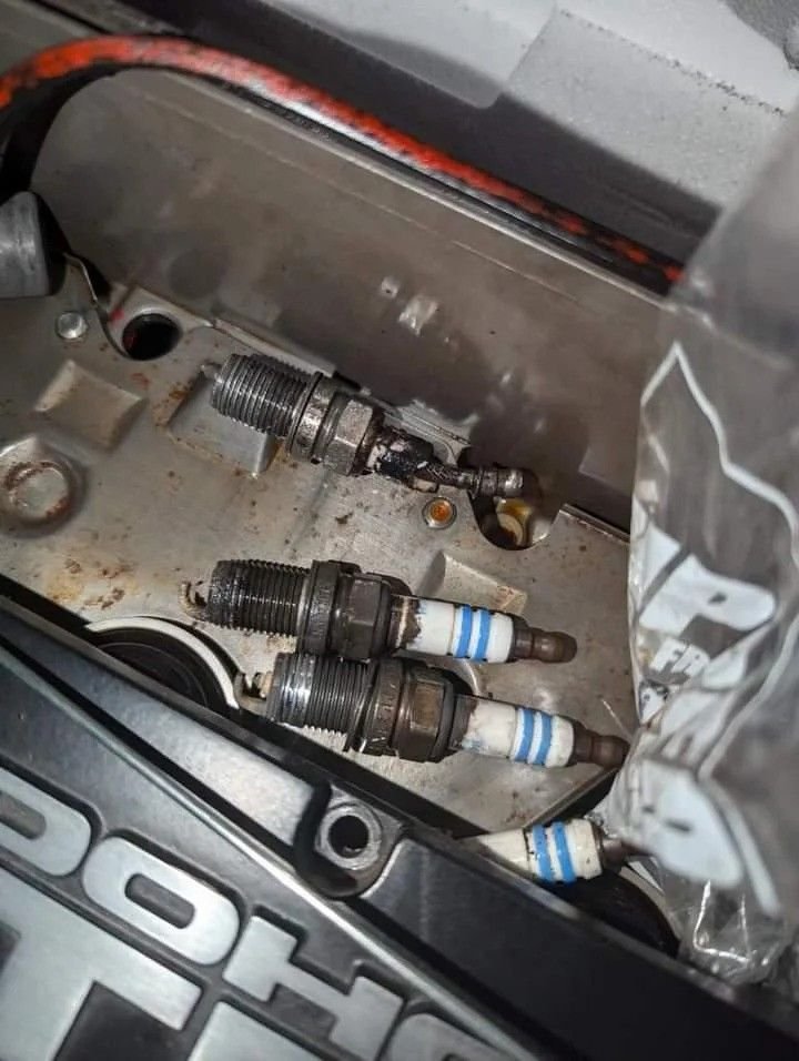

Check engine light hasn't come on since i plugged the crank sensor back in, the car has been running just as it did before all the crazy cylinder 2 issues, minus the idle rumble. Have been driving it around for a few months, no check engine lights, only things to note maybe a slight loss of power in VTEC but I think that's down the slightly lower compression due to a burnt valve on cylinder 2. I also think the bog on idle is probably some sort of intake leak as I ran a smoke test and it was coming from the manifold, i tightened up a few of the bolts, no smoke but still acts the same, kind of feels like heat bog but definitely isn't. I will also say the car has been fairly consistently running rich for a while, it wasn't as bad after the valve adjustment, but definitely on the rich side (again potential intake leak)
I don't know how I would check if the cat is broken (other than taking it out) there's no engine lights or sounds or unusual smoke, but given pieces of metal could have gotten ejected out of cylinder 2 it's possible. As for the plugs I don't recall which torque spec I used, but I remember reading something about AP1 engines having an under torqued factory spec for plugs or something so I took which ever higher value I could find online, and then for cylinder 2 because it had an insert, gave it an extra half turn ish
My fatal mistake (which I regret now) I never got around to fitting new plugs or coils when I put the new engine in, it was whatever the previous owner did. The issue of the spark plug threads was really my own doing, I was too patient to let them soak in oil when they were getting tight to get out and damaged the thread, I'm guessing the overheating of that cylinder made that spark plug hard to get out. So I have a few theories on why this happened in the first place. My TCT was going, evident by slapping marks at the bottom of the timing chain and the ticking. This caused issues in timing/my valves, the valves also could have already tight and required a valve adjustment (the shaking at idle), the engine running rich due to potential leaks may have contributed, potentially didn't bleed my coolant correctly. I'm not entirely sure.
The car definitely needs to be checked over by an S2000 Specialist, which is seemingly hard to come by in the UK, if anything for the ongoing bog and overly rich mixture, but also for a head rebuild at some point. But I'm just waiting on the funds really from a new job really before I start treating the car. I put this engine in on a drive while at university, so it was a huge learning curve and it could have been done a bit more thoroughly, but I'm just glad it works (for now)
(Also attached
a pic of the mangled plug)
(Also attached
Holy Macaroni! Are those the spark plugs from the current engine in your car? Not only stripped threads, but I don't think I've ever seen one with that kind of insulation damage!
Was the engine making any knocking or other pre-ignition death rattles?
Thanks and good luck with the fix!

Your underlying cause was a loose spark plug.
It is imperative that the spark plugs are tight. Loose plugs will allow un-metered air into the cylinder, leaning the cylinder, overheating it, and melting the spark plug and the coil.
If you so much as touch the crankshaft without the tct in bolted place, you are guaranteed to jump the chain and cam timing will be off.
