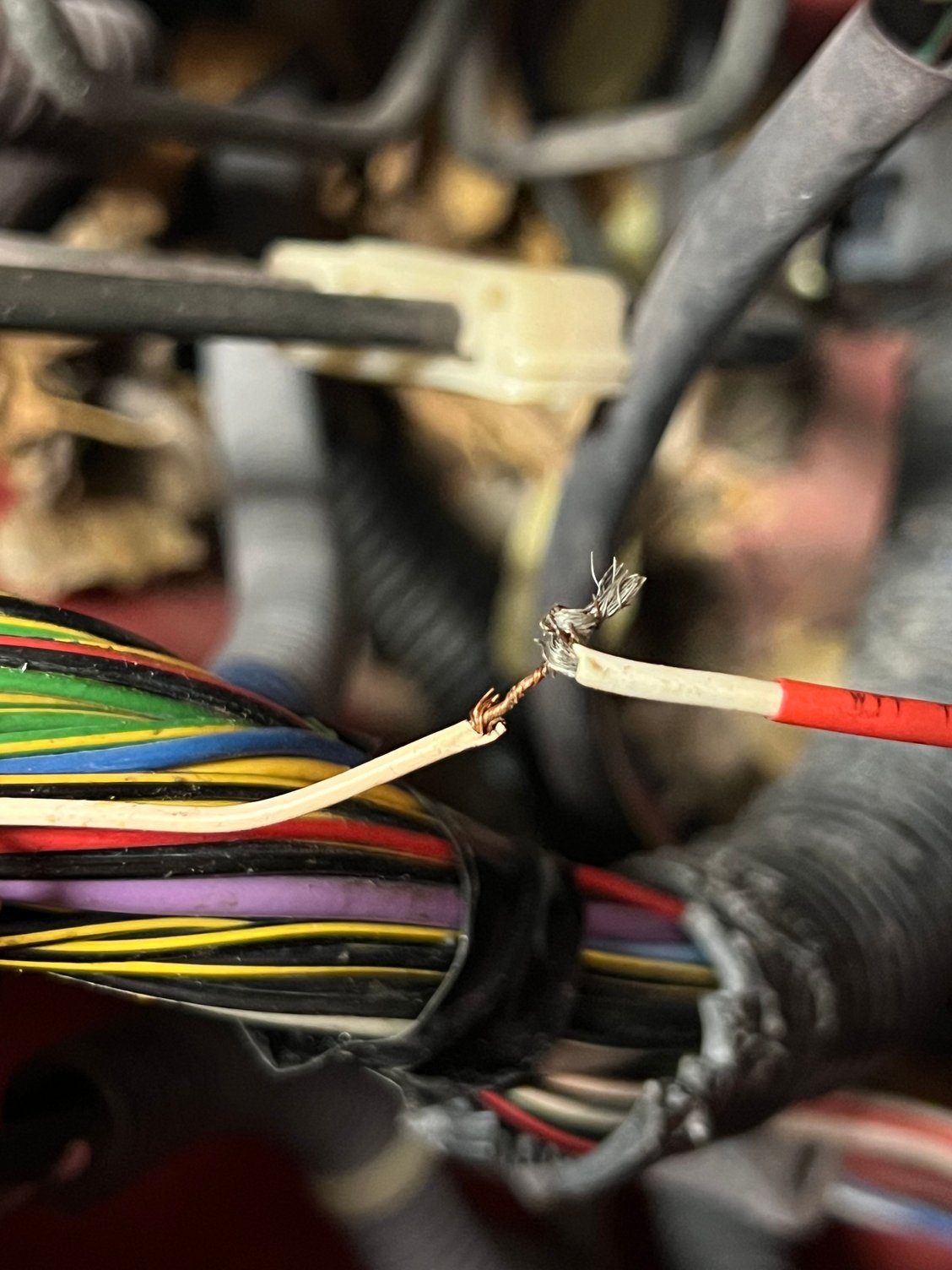

Ended up being a wiring issue, someone before me poorly spliced the ground wire of the ckp connector which caused the P0336. Repaired the broken wire, clear CEL and drove perfectly!
This what the damaged wire looked like.
