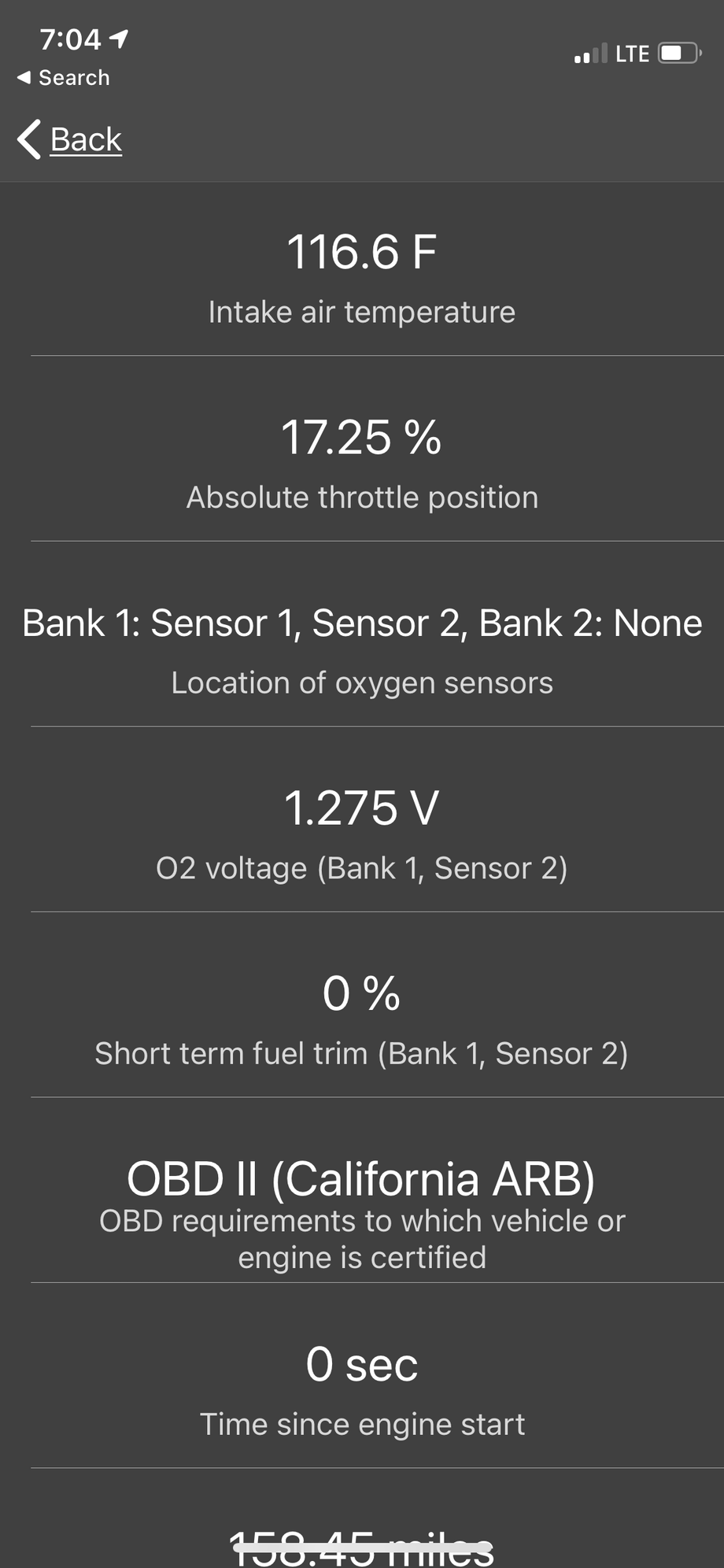

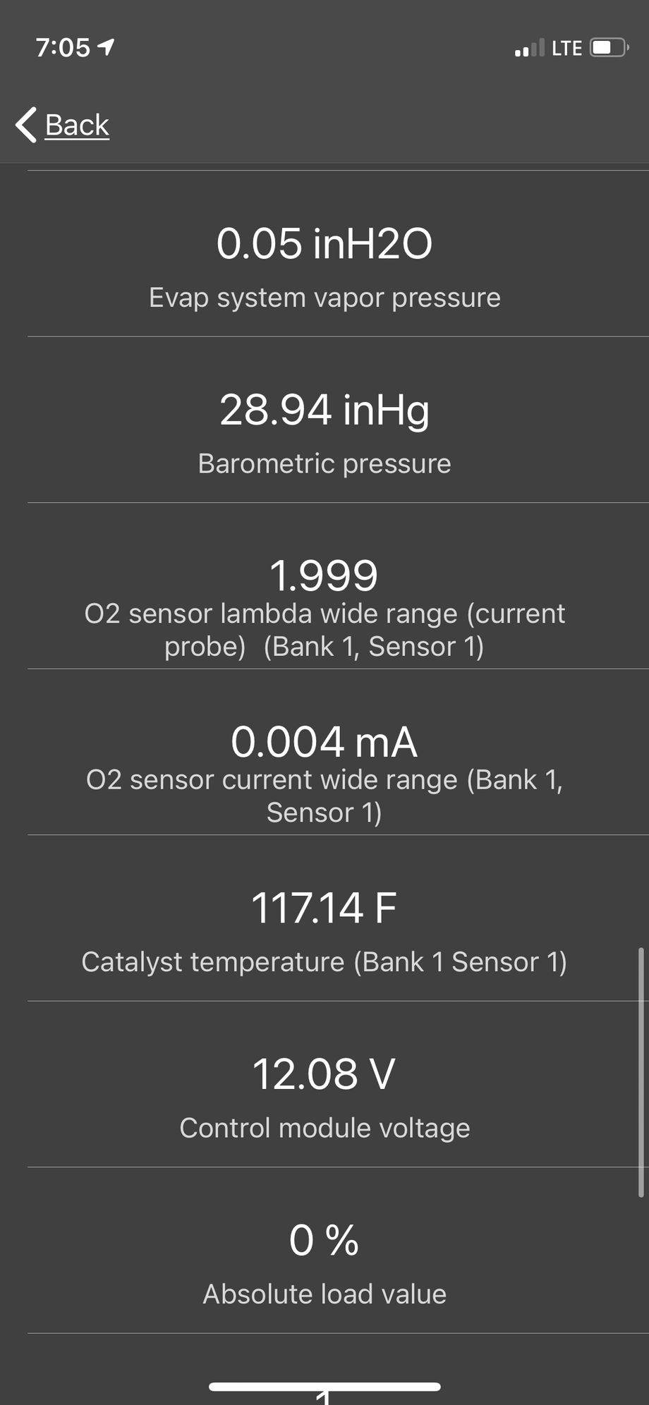

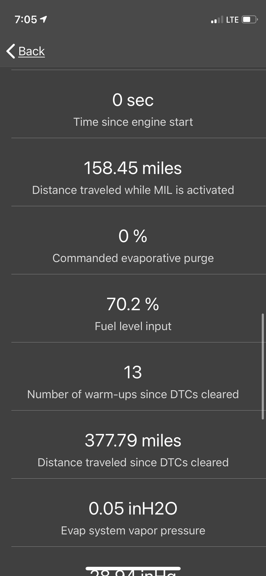

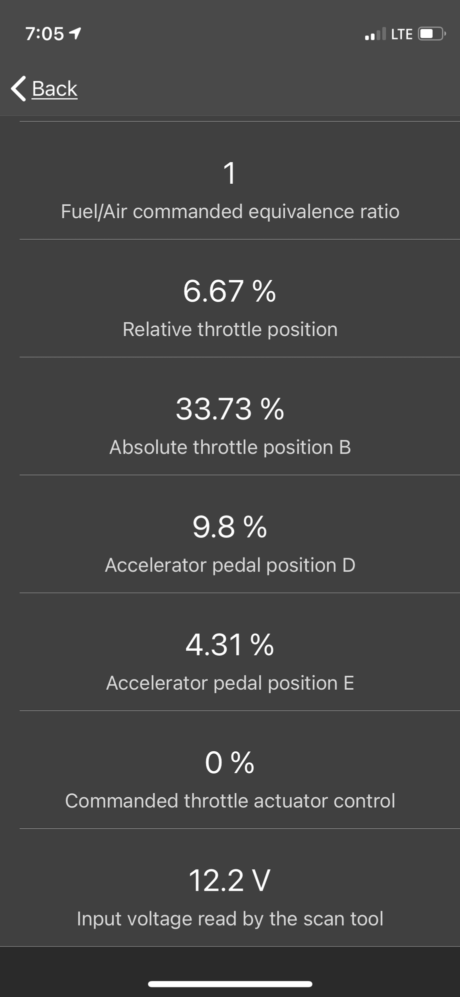

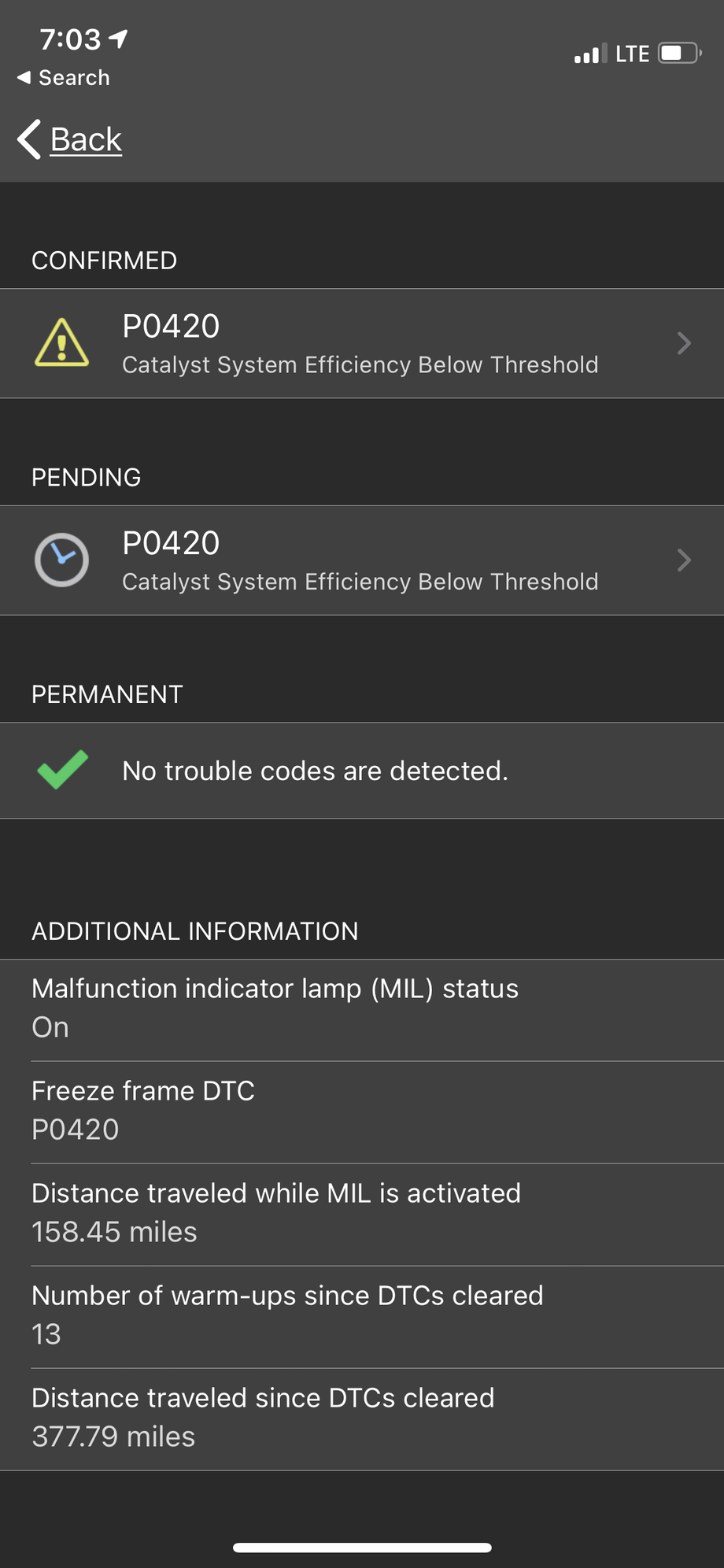

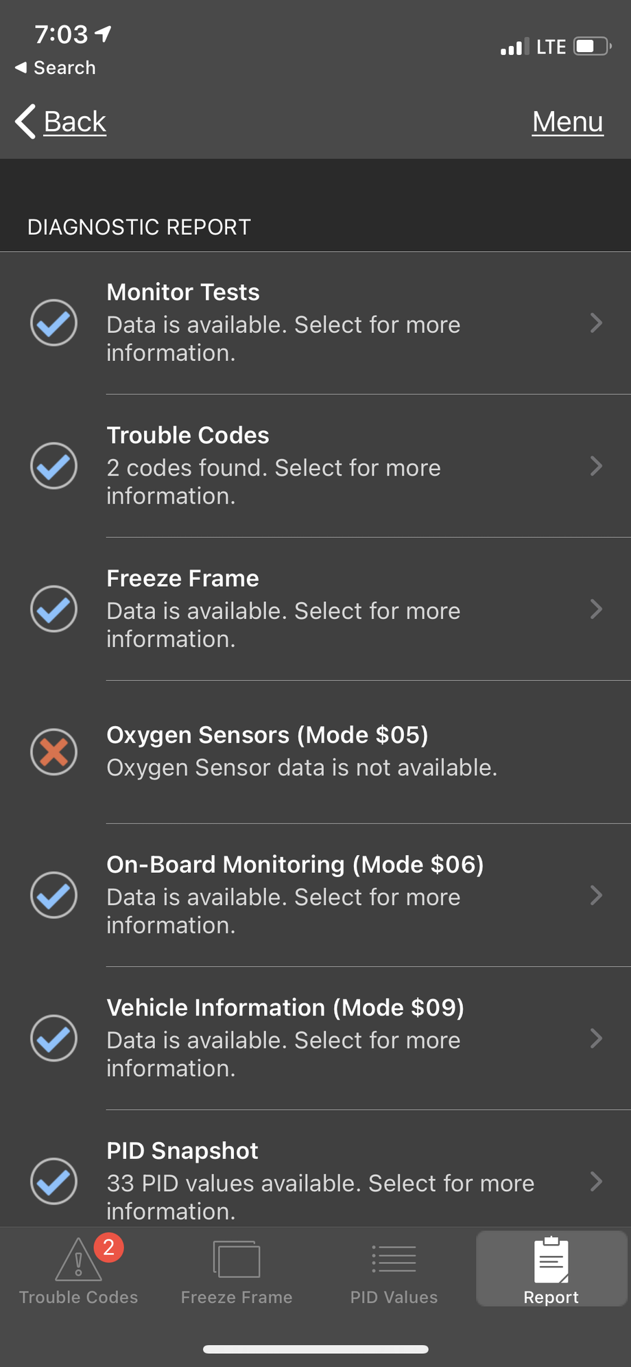

I have been dealing with this intermittent issue for 3 years.
  1. The classic issue where the cell of the cat cuts the original o2 sensor in half. Replaced with used OEM cat and Denso 234-4353 sensor. Solved issue.
  2. Drove over something in road and damaged o2 sensor, replaced with another and all was well.
  3. The 2nd sensor failed soon after install (30 days) and got a replacement.
  4. The 3rd sensor worked for almost 1 year then starting becoming intermittent. Replaced it August 2020
  5. The 4th sensor new as of August 2020 is now doing the same thing. It will intermittently throw a P0420. The light could stay on as little as a few days or as long as a month or so. The only pattern I have seen is this can happen when the weather goes from 80f to 40f or so.
Any thoughts on this?
STOCK 07 AP2
Question:
1. How do you determine if the cat is good / bad?
2. What is the sensor named in the ODB software? / voltage range should I be looking for?

P0420 does not indicate a bad o2 sensor, it indicates the opposite (it is working)
You need a new cat, or a right angle spacer for your o2 sensor (you have a few good o2 sensors sitting around)
