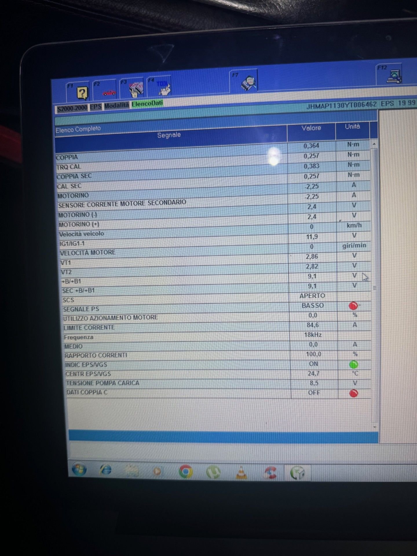

good morning, I'm Italian, I have a problem with my S2000, year 2001. The car's steering has never worked well, in my opinion, it's hard both on the right and on the left. The EPS light goes off normally when driving, but when I try the SCS procedure, the EPS light doesn't. it remains fixed and does not display any errors...in 2022 on ebay I bought a complete rack with torque sensor in good condition but I didn't solve the problem...I'm waiting for an EPS control unit to try, what do you think will I be able to solve the problem?

this is my screen

Can you change the language on your reader to English? You may get a better response.

ok when i return to box i make it im waiting eps unit for try i hope to resolve it

'' motorino ''is a motor Volt power steering 2.4 volt (m- m+) ONLY when turn steering
the correct value is 12.5 volt...
is impossible reset EPS ...in SCS mode light on and never turn OFF
