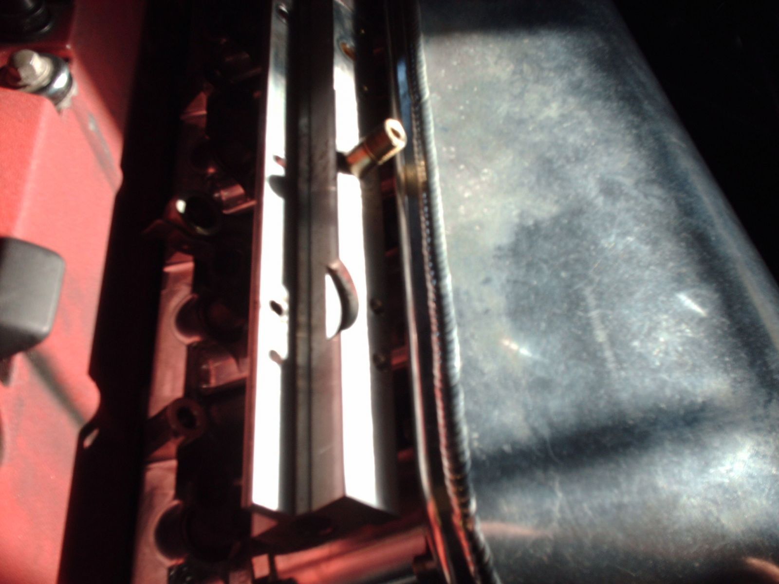

As some of you may know i'm putting on the Hypertune intake manifold, for the second time. We ran into yet another problem.
The FPR hits the plenum:
I found this:
http://www.jegs.com/webapp/wcs/stores/serv..._10002_27423_-1
Is there any reason i shouldn't order this or is there a better deal somewhere else?
As of now i'm going to order this tomorrow and we are going to have to tap the rail and run som AN fittings to this remote FPR.
Any thoughts are welcome.

Isn't the comptech FPR external too? I don't think it's that uncommon.

Comptech's unit is a rising rate FMU, not quite the same as a regulator, although it can be used as one. Probably not real cost effective.

the aeromotive is a good unit.

I wasn't suggesting the comptech unit, just that a firewall mounted FPR isn't that uncommon.

How are you going to solve the fuel delivery line problem?

Jegs has fittings to addapt a rubber line to a AN line. Were going to extend the line with a new banjo and run in up inbetween the runners.

Thanks. I guess I'll be doing the same thing if mine ever arrives from Full Race. What size banjo bolt is it?
