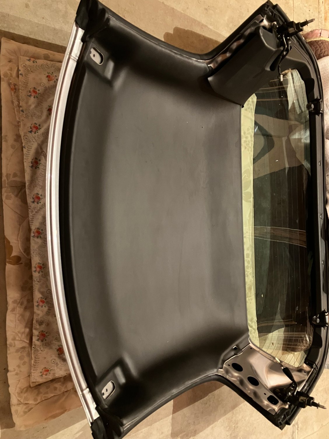

I have cleared the headliner from all but the clips. I understand that the liner must be slid forward until the clips reach the enlarged area that allows them to be freed by pulling away from the metal top. I’ve tried to slide it, but very little movement for what seems to me to be WAY more effort than it should require. I don’t want to damage the liner, especially, nor the clips (which is what I call the parts glued onto the liner that fit into the notches and hold the liner in place when slid backwards into the tighter/narrower area of each notch). Any tips on how to proceed? I’ll include a photo of my present point of progress. (Note: the B-pillar on the left is completely detached from the top and out of the way of the liner)
Trying to remove this liner. Cannot get it to budge forward to align clips on liner with larger notch point on top that would allow the liner to detach from the top. Any ideas/suggestions?

not sure if you were able to figure this out or not but one clip holding the headliner is similar but different. Front center clip is designed to pop out. Once that clip is released then the entire liner can be slid forward and out.
