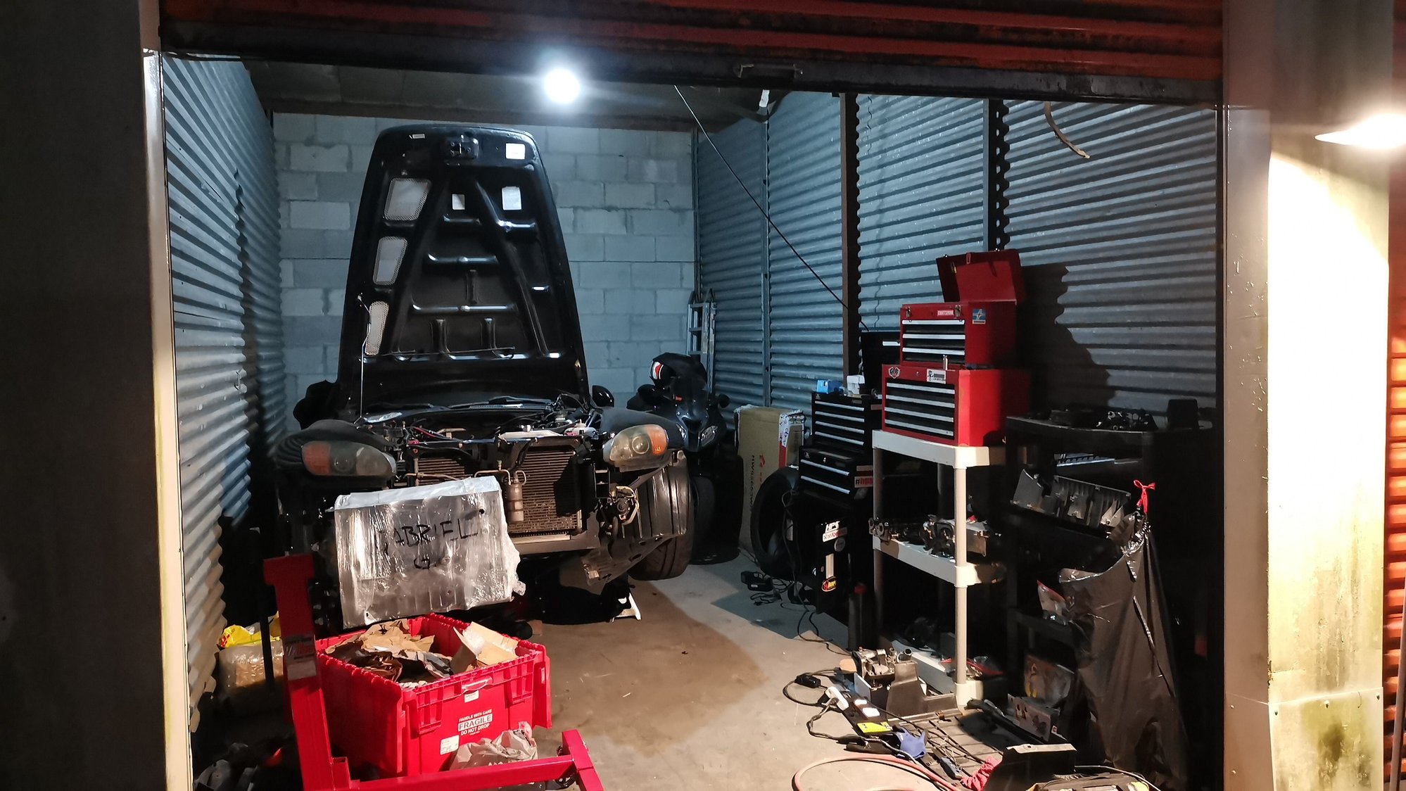

Have been doing an engine build since September and due to unforeseen circumstances, it's still not installed in the car. Since I did not plan on taking this long, I DID NOT get a full tank of gas and add fuel stabilizer. So, since this fuel has been sitting for 4 months now and probably an additional month, I am worried that it might cause some damage to the fuel injectors and the new 2.4L engine.
So my questions are:
- Should I even be concerned or is it not an issue?
- If it's a problem, is it safe to connect the battery, prime the fuel pump and drain the fuel through the main fuel line that goes to the fuel rail?
- I thought about adding some sort of additive as well but I don't think it would help since it wouldn't mix in the entire system anyway.
I appreciate any advice given.
