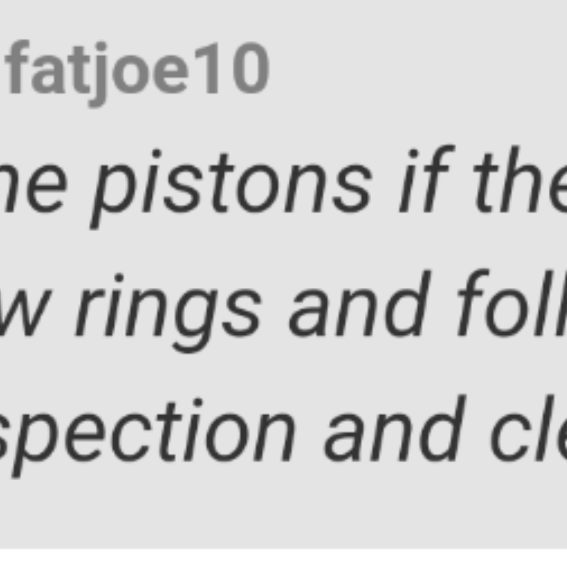

You can re-use the pistons if they check out OK. Simply install new rings and follow the repair manual procedure for inspection and clearances.

Reusing piston rings? Really? Lol.

Ummm he said pistons, not rings.

I'm apparently just dyslexic and reading vertical today
