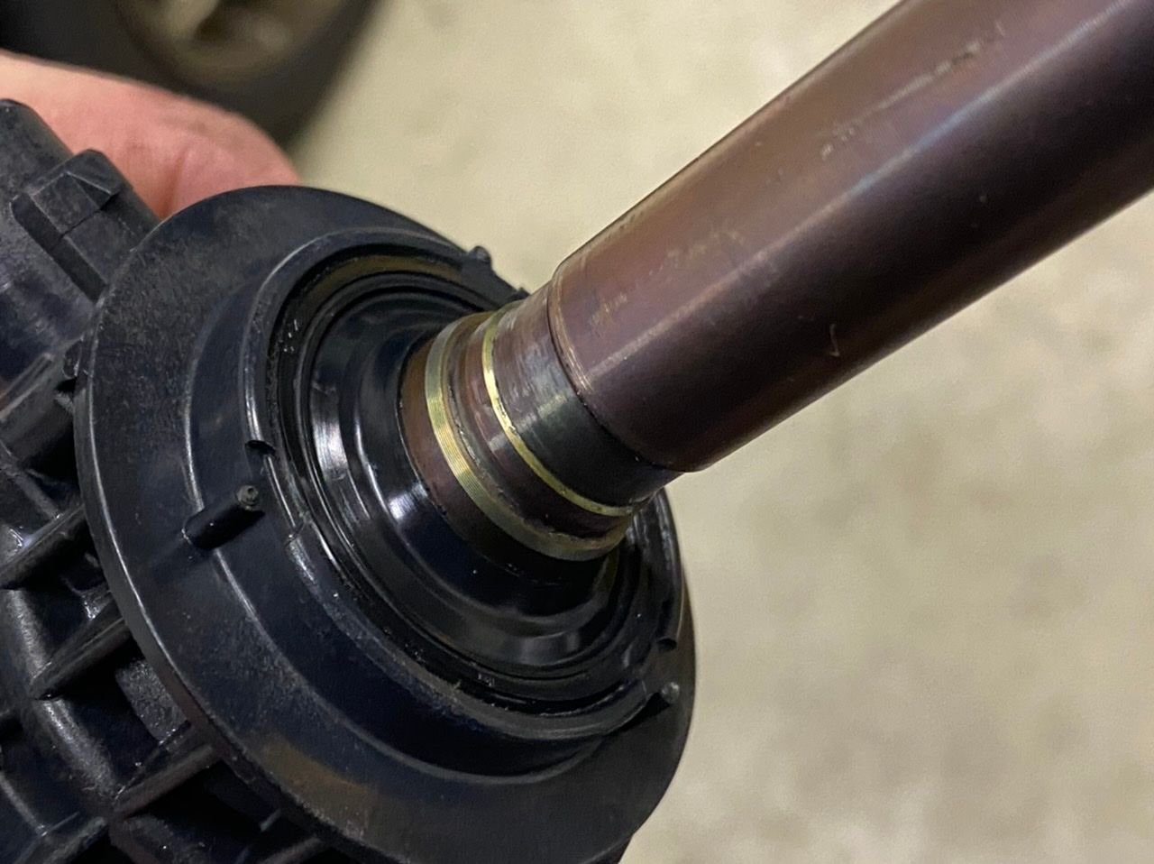

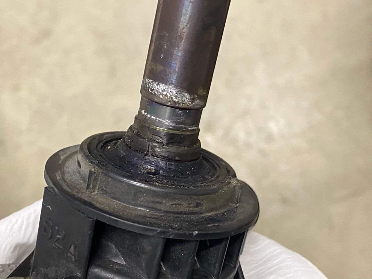

Here's what my steering sensor looked like on my 02 w/ 50k miles; I'm assuming this is the first time it's ever been apart/inspected.
And after with just a little bit of degreaser on a rag.

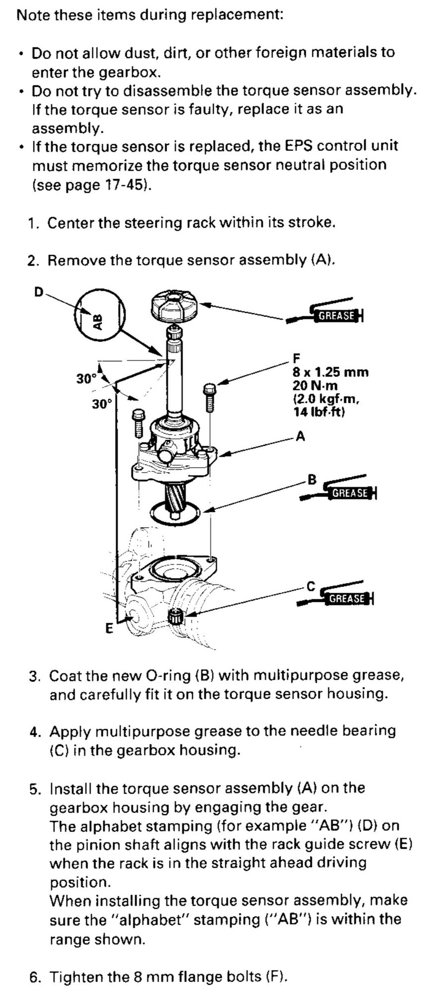

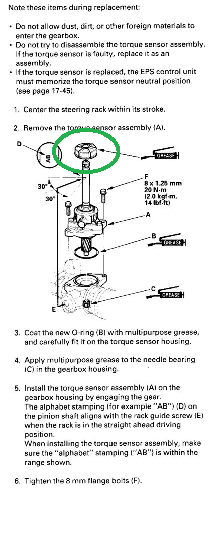

Per the FSM, it looks like you only grease the cap.....which I'm assuming is on the inside of the cap in the cavity around where it rests on the steering shaft? Wish they were more specific. Regardless, I don't think a lot of grease is used here.
