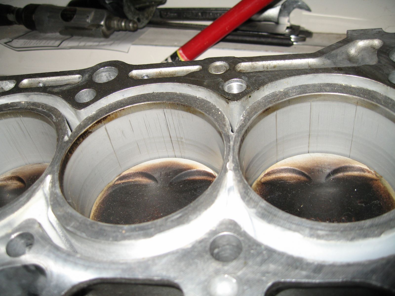

I had good compression and every single one of my cylinders were scored.
I never had a CEL. Car felt sluggish and ate a lot of oil. Spit oil out of the exhaust just like yours did. You have a problem and are in denial..may turn out to a small one but if you do not take action (do not drive it) it could turn into a big one.
