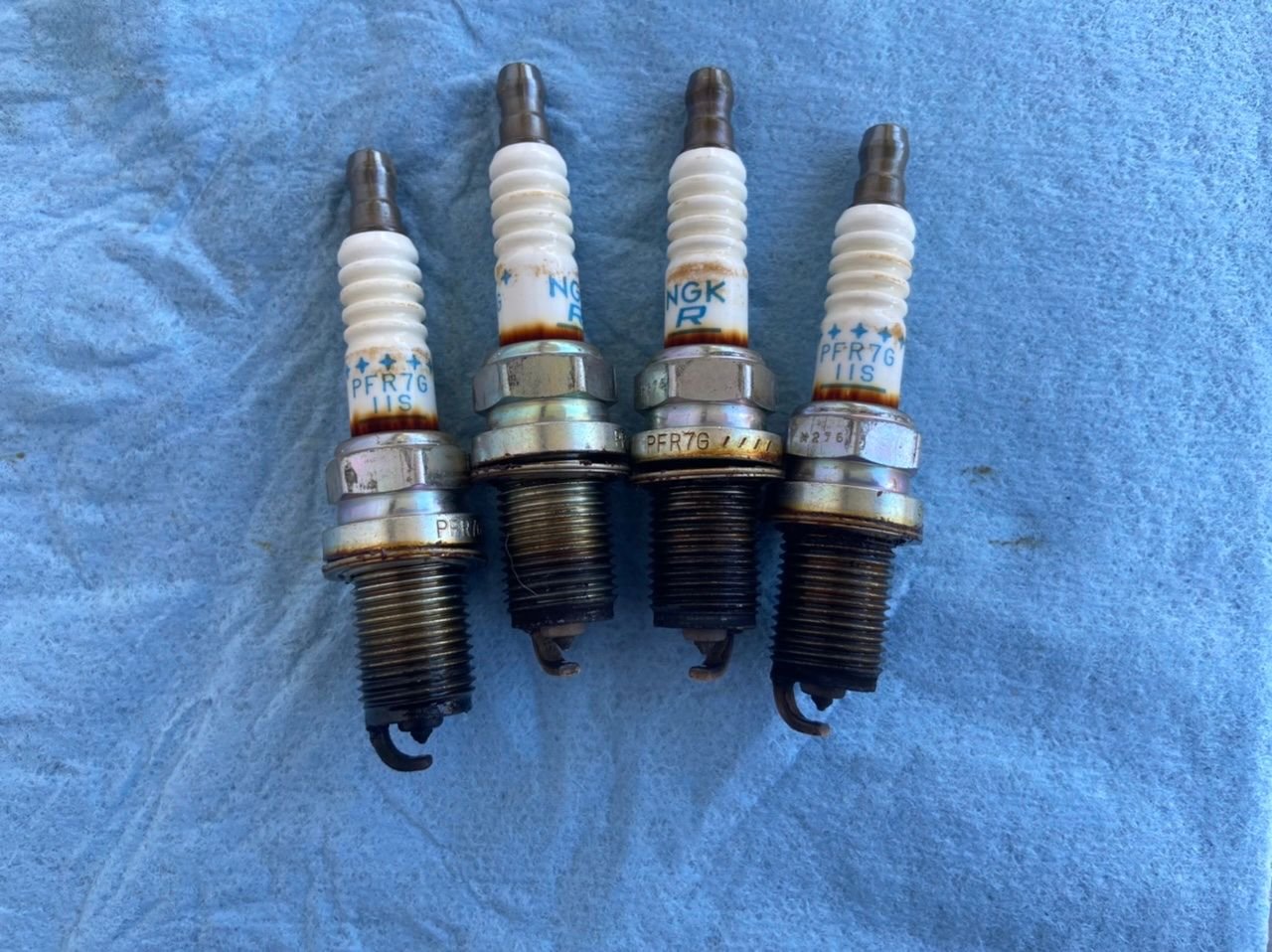

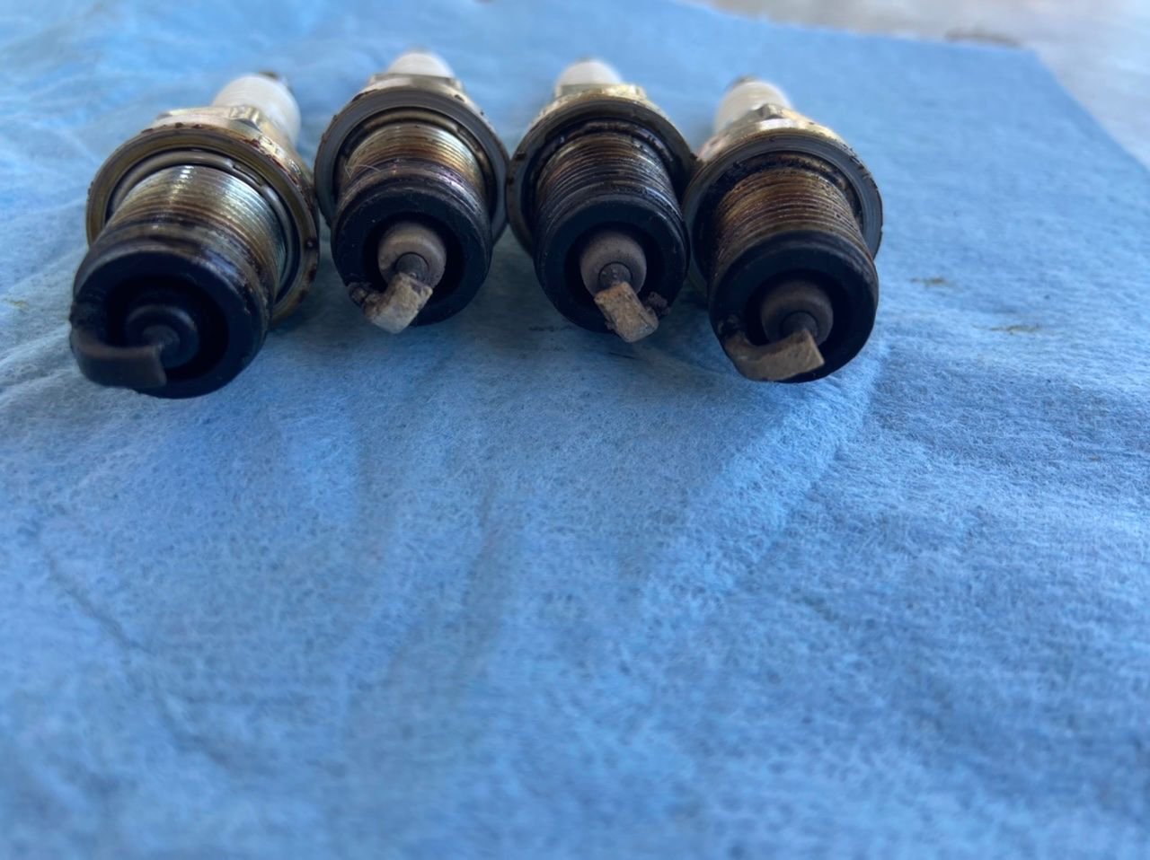

Thanks to all of the comments. Billman, I try to keep the oil level just below the high mark, measured on the driver side of the dip stick.
I pulled out the spark plugs and they all have oil residue. If it was a mechanical failure such as valve stem seals or piston rings, wouldn't the all 4 cylinders having the issue seem highly unlikely? Perhaps its some sort of crankcase ventilation/pcv valve issue that is effecting all of the cylinders? I did remove and wiggle the pcv and the ball within it shakes freely.
And here it gets even more confusing. I possibly have fixed it, at least for the time being. I changed the oil in preparation for the winter storage and after driving for a while the smoking is gone. Did the old oil thin out and was somehow making its way into the piston chamber and burning?

If your old oil had a lot of moisture in it, it may have been causing the smoke.
Maybe you make a ton of short trips and the oil has been in there forever.
Still very strange that an oil change cured it.
BTW, one of your plugs looks much more sooty than the rest.

The far left spark plug is the only one looking oil-fouled. The far right looks like that cylinder was burning rich. Two in the middle don't look bad.
