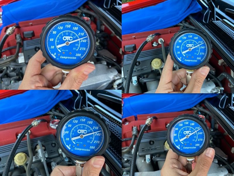

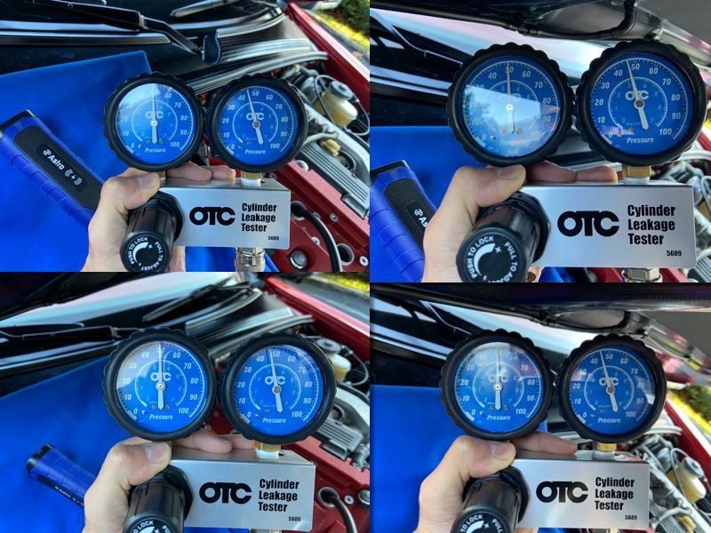

Had a hiccup with the borescope device but got the compression test and leak down test done. The compression is between 220-228psi while the leak down is about 10%. All cylinders have similar numbers.
Old Nov 19, 2021 | 08:14 PM
  #37
B serious's Avatar
Joined: Nov 2007
Posts: 8,841
Likes: 1,705
Probs just valve seals
