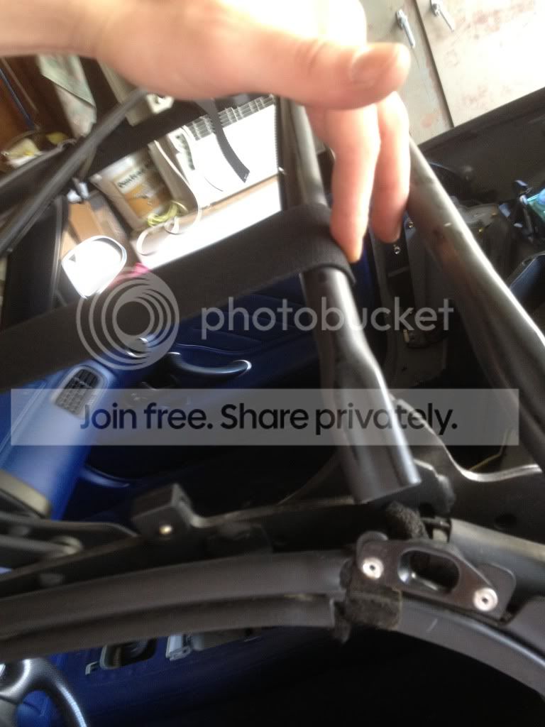

Hey guys i'm in the middle of doing this so please give me feedback asap.
I'm at the stage where I'm putting the rear soft top back in place (the plastic rain guard thing and metal brackets)
Do these rear straps attach before the plastic? In between plastic and metal holders? Or after metal holders against the nuts?

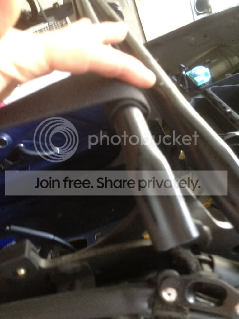

I also purchased modifry straps:
Does the rear of strap attach like this without looping (as above)
or like below where it loops around once?
If it loops it is very tight and the strap stretches a fair amount. If it doesn't loop there is a LITTLE tension in the strap and it stretches a little bit

Rear strap attached AFTER top and rain rail, before metal bracket.
Loop the modifry strap. It should have a lot of tension to pull back the bar.

In my first picture is the strap secured in the correct place?

Yes, one stud back from the front. so you are correct.
Rainrail, then strap, then metal retainer.
Put the middle back retainer in first. If you put the two sides first, the middle wont fit
