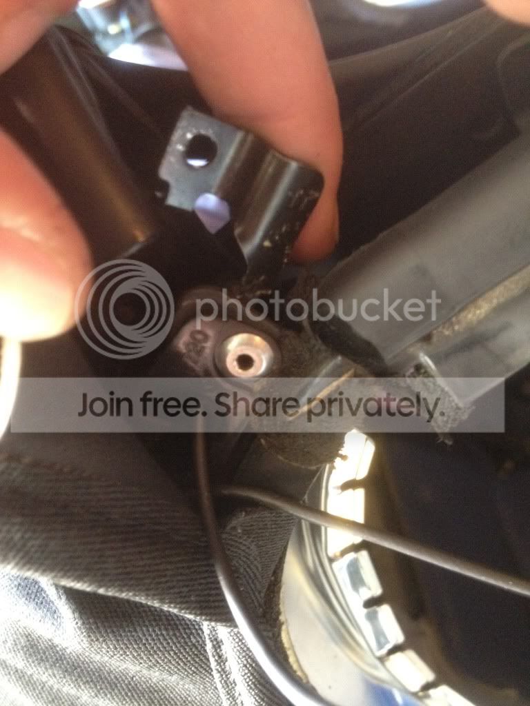

I can't get those brackets to fit at all (where the 2 screws go near the bottom of the window)I think an OEM top would have aligned much better

post pics so you can show us what you're dealing with.

So as you can see from the picture I took the cable and went from the outside in... is that correct?
