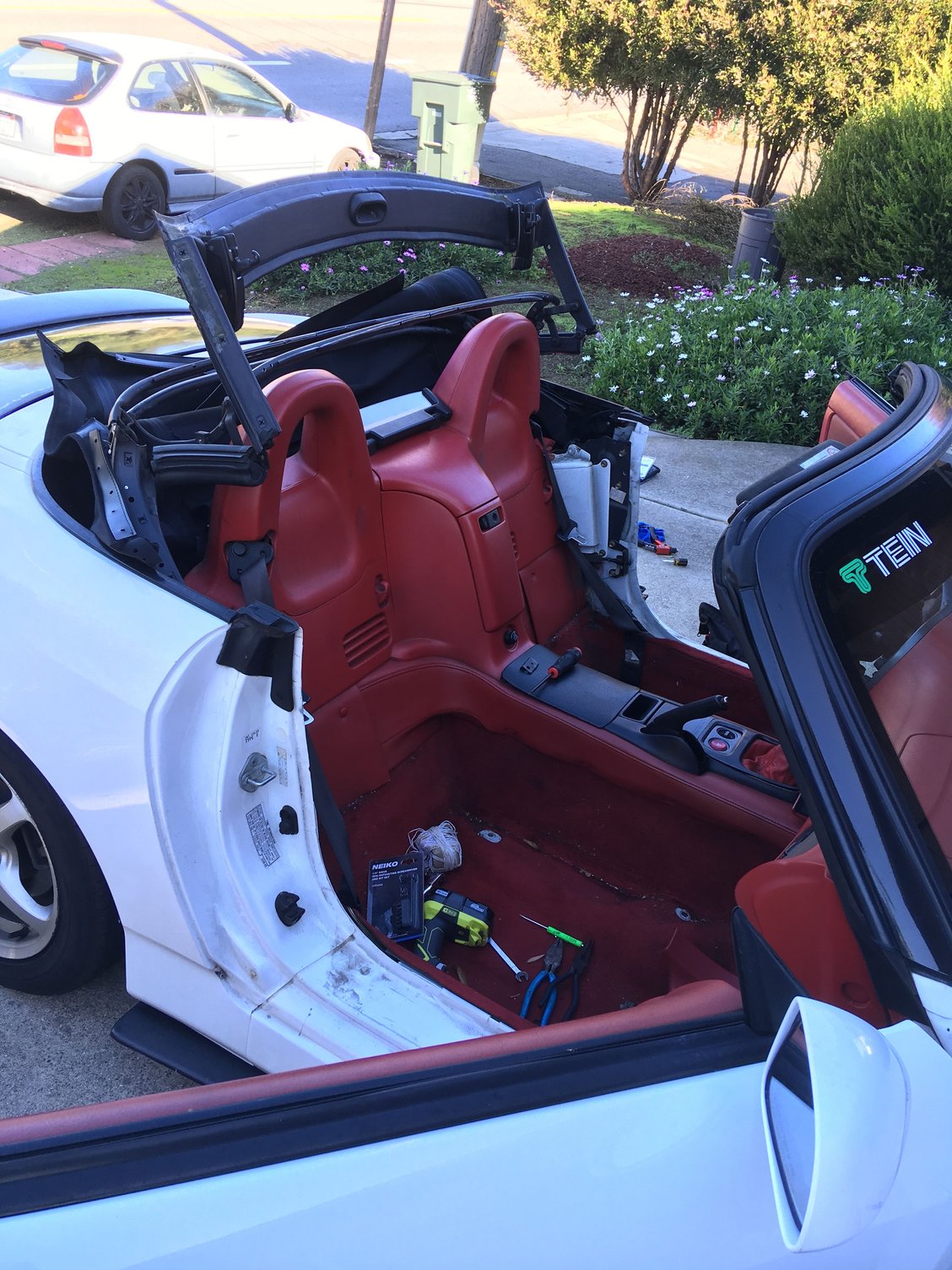

Default Mission accomplished
Took 7.5 hours with a friend. I did the job right after working all night and was tired but got it finished. It’s completely unnecessary to take everything out of the car besides the seats and front/back sill panels, lower door kick panels. Also It might be easier if you take off the center windscreen (i did not)
i forgot to put on the metal rain guard with the rain rail and had to go back after the top was installed and put it on making things harder on myself. Also rivets aren’t really fun to use with a cheap rivet gun. When opening the driver door, the window snags the side binding of the top a little when it’s up, otherwise a clean install I’m happy it’s finished as i had the worst s2000 soft top in the world before this install.
