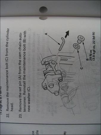

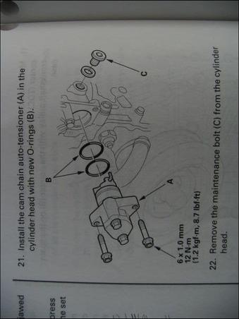

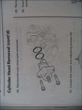

Originally Posted by beanolo,Jul 9 2005, 04:59 PM
Well yea i know its in the helms, just dont have one and was wondering if anyones done a online DIY..
If you are replacing the tensioner with a new one, here are the relevant sections of the manual:
Remove the 2 bolts that secure the tensioner to the block, then remove the tensioner
lube the o-rings with a dab of oil, then insert and replace the bolts. Make sure the bent portion of the retaining pin on the tensioner faces the front of the block.
remove the maint. bolt from the front of the block, then reach through the hole with a pair of needle-nose pliers and remove the retaining pin from the tensioner. Then replace the maint. bolt.
