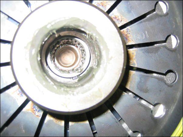

I gave the alignment a try just by eyeballing it:
The sucker slid right on, first try. :dance:
Thanks for all the suggestions, guys!!!
