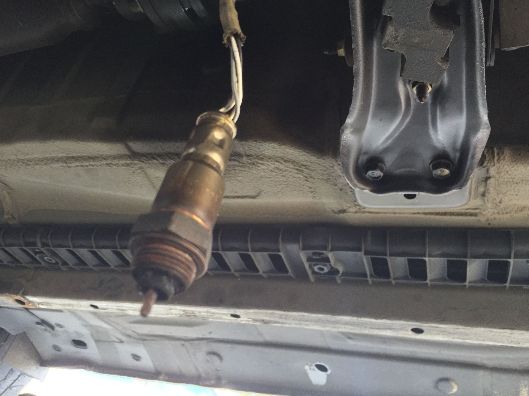

So I guess my sensor is broken? Thought it was supposed to have a thicker cylindrical tube. Well, I'm getting a cat and new sensor next week. Sorry for the huge picture, didn't know how to resize it.

Yes that certainly looks broken

That would definitely result in a high voltage reading lol
