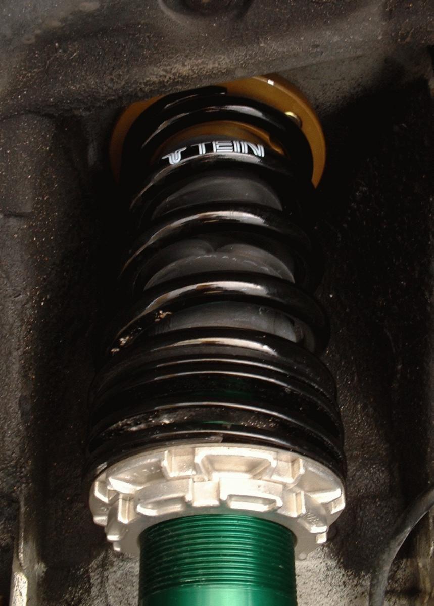

I recently installed the Tein RA's and have my alignment and corner weight appointment set up for next Monday. I currently have them set .9" lower in the front and 1.1" rear. I'll let you know how close to stock is possible at these ride height settings. We will continue to adjust the height until we can produce reasonable alignment settings.
BTW, my goals for the suspension changes were to reduce the car's positional change and to be able to change the car's over/understeer behavior by adjusting front and rear ground clearances. Basically the same goals discussed in the Mugen S2000 development paper. I have lowered the rear of the car more than the front in an attempt to dial out some oversteer and make drift control easier to achieve.
Of course, I have not had it out at the track yet but it appears that these coilovers are very tunable. Tein says they are 16 point adjustable but for some reason my dampers seem to have 21 adjustments on all four corners. The dampening adjustments have a wide range from near stock to almost locked out. For the street I have the settings at 8 front and 4 rear. The ride is easy to live with even thought the springs are rated at 10kg/mm front and rear, more than twice as stiff as stock! It just goes to show what a high quality damper can do for ride quality.
Here are a few post-install pics.
