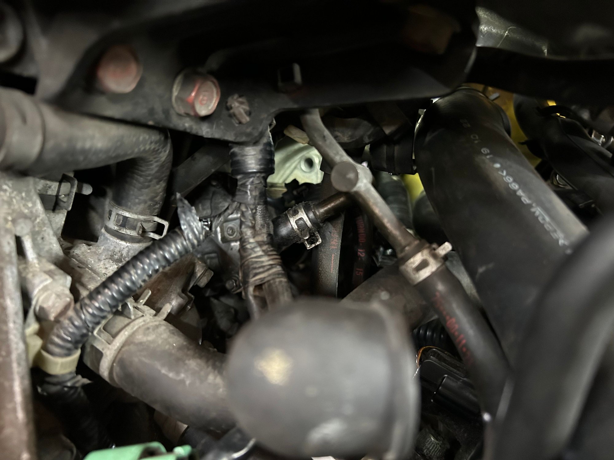

Ok, many have figured this out but some still struggle with it and I have had a couple ask about it, and since I was doing the clutch I thought I would add some pics to the normal half arsed description I give on how to put the top bolt back in. I have done this way a number of times and it is easy this way, so figured I would share.
So the bolt is WAY back in there of course. And the bottom starter bolts comes out easily from the bottom side. The top is easy to get out once you find it, but some struggle getting it back into place.
If you shine a light down between the intake runners and peer around (assuming you have the alternator out of the way) you can see the bolt. Here, it is already removed, but the bolt will have a red head on it.
Now, here is the key part. You need an extension or combination of extensions to reach the bolt from the front of the motor (through the spot the alternator sits). Also, do not just remove the alternator top bolt and swing it out of the way, just remove the alternator It takes another minute to do so and gives you more visibility. Take your time to shine a light down there and find the bolt so you can clearly see it.

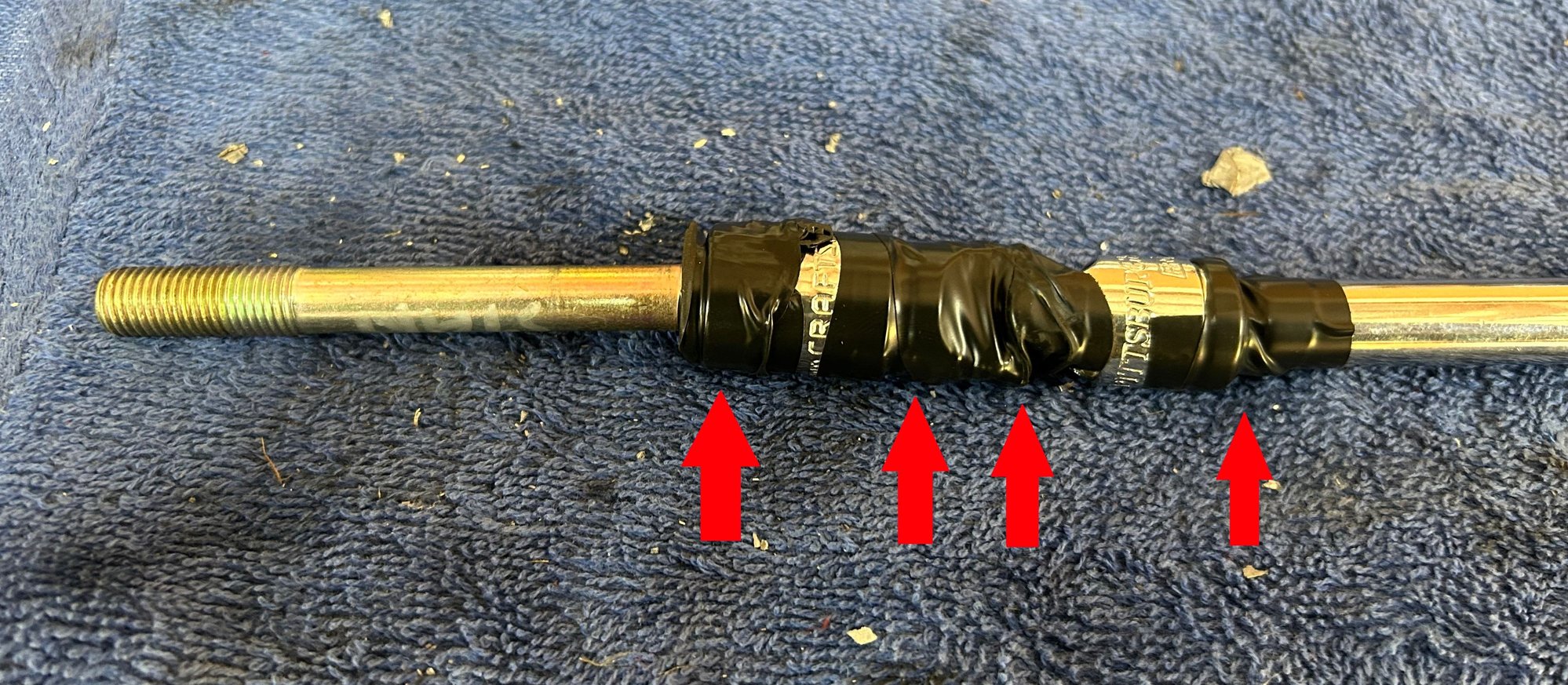

Below I have marked up a pic of what I did with explanation below it.
Now, you can use different types of universal joints on your extensions and some hold their position better than others. I am using standard old style universals here as many may be using and thus, the tape method really helps. I will explain each arrow, left to right.
First arrow (far left): I have placed a piece of electrical tape around the end of the socket just barely folding over the edge of the flange in the bolt. This holds the bolt in the socket. Most magnetic sockets I have tried end up dropping the bolt as it is too heavy. This method ensures the bolt stays on the socket, but holds loose enough to just pull off once the bolt has started.
Second arrow: This tape holds the socket to the universal adaptor. This way, when you pull the extension to pull the tape free from the bolt head, the socket says with the extension, not the bolt
Third arrow: I wrapped the universal adaptor with a turn or two of electrical tape. This allows it to flex enough to get the bolt in place, but not be floppy so it always just points down.
Fourth arrow: Taping universal adaptor to the extension. Same purpose as the second arrow.
Now, once you have done this, it is all very easy from here.
1) Fish that bolt into the starter hole. Keep track of the knock sensor and do not get caught in its wiring or hit the sensor. It breaks very easily!
2) Thread it in a bit to get the bolt started
3) Pull the socket off to pull the tape free (so it does not get caught under the flange of the bolth when tightened).
4) remove the tape that was on the socket holding the bolt on.
5) place socket back onto the bolt and tighten the rest of the way.
That simple Just always keep in mind to keep the extension angled a bit to the right so you do not get into the knock sensor and damage it. If you DO damage it, just go ahead and pull the starter back out. It is super easy to replace the sensor with the starter out, but you cannot even see it with the starter in.
Electrical tape works very well for this since it has some stretch, especially if you use good electrical tape.
As a general note on the starter, top bolt comes out the top. Remove belt and alternator and the intake if it is in your way. I have an aftermarket intake which frees up that space, but also had it out anyways since I was doing the clutch. Once the top bolt is out, everything else is done under the car. bottom bolt is easy, wiring is pretty easy, then carefully pull it out the bottom. Again, when taking it out and putting it in, be aware of where the knock sensor is and do not bash it with the starter. Once the starter is out, look at the knock sensor is and take note for when you put things back together.
Putting it back in is the reverse, but pay attention to where that little spade connector goes. You cannot see it with the starter in and you have to kind of remember where to start feeling around for it. Work the starter into place, put the bottom bolt in finger tight only for now, put in top bolt as above, get back under the car and tighten bottom bolt and attach the wiring.
