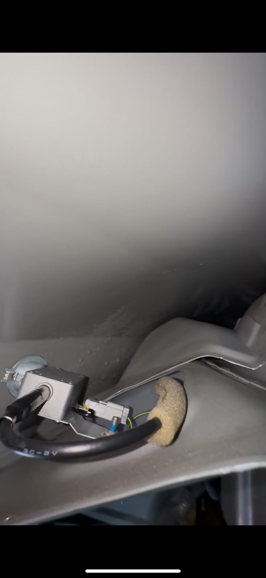

Would anyone know where is the water come from? I have researched many of discussions about this trunk leakage, I have no idea where is the water come form. In the photo can see the water come behind the antenna . Thank you very much for any answering

Have you checked the software top drains? They clog and overflow.

Yes, I have checked the soft top drainage, boot vent, tail light, the antenna. All no leakage. I really no idea where the water come from. And the pictures shows it more likely a surface
condensation. (| guess only) But it is weird that this problem only appears in driver side, no problem at all in passenger side (RHD) . Thank you very much for your reply and helping

if it is that high up it might seem to be the antenna , maybe the base needs to be tightened on the antenna ? I don't see anything else that can leak from that location ?

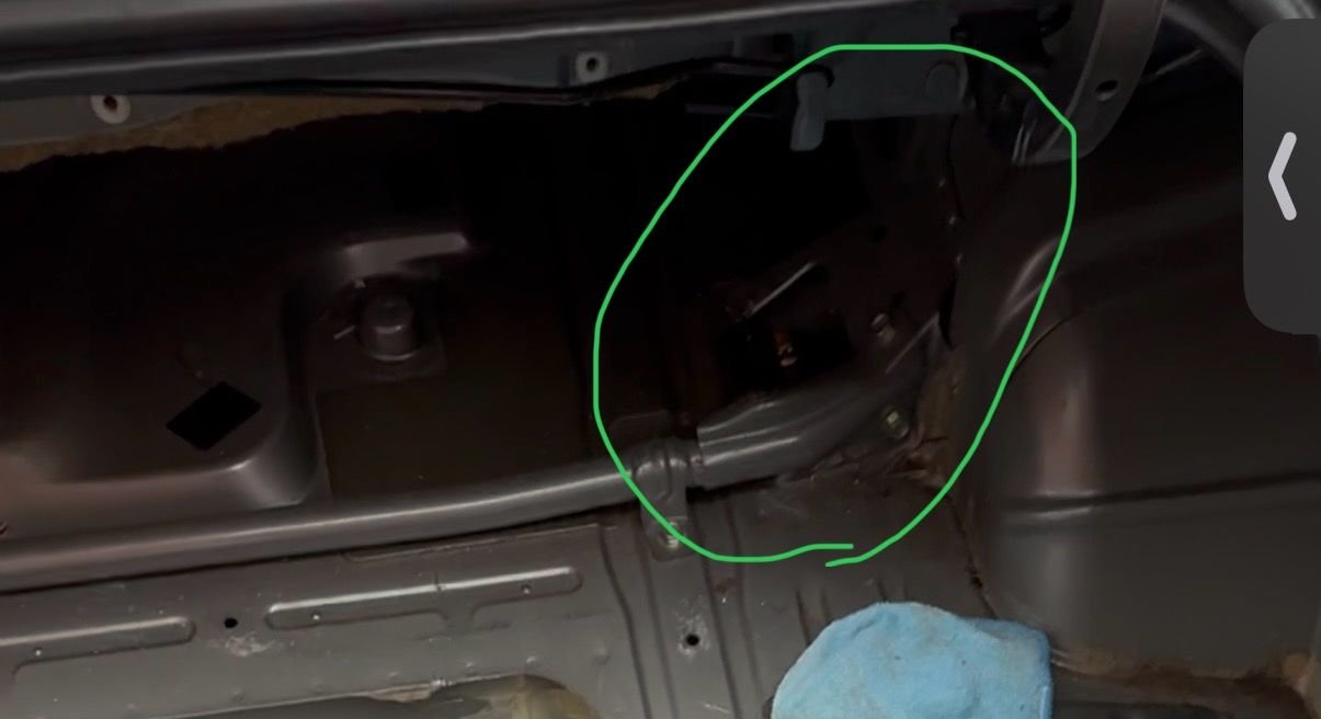

Thank you for your recommendation.I will try that. And I found that there are another leakage I. The trunk

run a hand under the edges all around the top mating surfaces, maybe theres a pinhole. otherwise do it the old fashioned way and spray it while you look.
