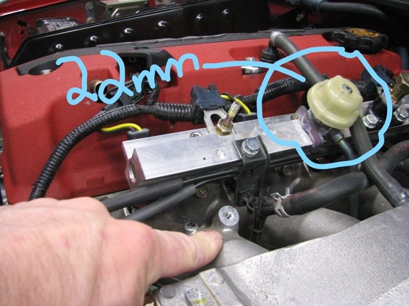

With regular cars it is very simple to remove bad gas as 9/10 times they have a drain. Our car does not haha. There is only two possible ways to remove the gas out of the car. Through the fuel rail or drop the whole tank. I personally go through the fuel rail just because I cant drop a full tank by myself. Another reason is that if your car is misfiring due to bad gas it is likely because of water in the gas. Gas floats on top of water and because of this you CANNOT siphon it out. No matter how hard you try you cannot get the hose to the lowest part where the fuel pump is to remove the actual bad gas. If you siphon it, you'll be removing good gas actually. To remove the gas throughout the fuel rail you need to remove the hose connection to the fuel rail.
As I artfully drew, it is a 22mm wrench. Remove the plastic top cap and you'll have access to the nut. You can use a adjustable wrench but take caution when breaking it free. There is a gasket under there and it is a specialty order, most honda dealerships wont have on in stock. A trick is to tighten it a little bit then loosen it. This will help ensure nothing strips and keep the gasket from ripping. Once you have it free feel free to use your imagination on how to get the fuel from the hose connection into a spare gas can. I drilled a small hole into a bottle and then shoved a 1/4 inch tube into it for a snug fit. Cut a large slit into the bottom of the bottle and shoved the hose connection into there as it has a circle attached to the hose. I taped it up and it formed a good seal that did not leak. When you turn the key it primes the fuel system and gravity will bring it down the 1/4 hose into the gas can. I usually have a couple of empty bottles to test the drained gas into. Let it settle and look at the bottom. If there is water then you'll know. It'll look like oil at the bottom of your gas. Repeat this until you are positive your lines have good fresh gas in them.
