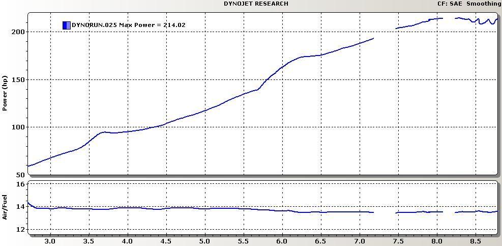

I haven't done a writeup, since marcucci and I were planning on producing them. I finished the prototype about 7 months ago, but never did get around to starting the production unit. Basically, it is a piggy-back with a WBO2 input. It monitors the WBO2 while it tunes itself. It worked much better than I could have hoped.

Here is a dyno plot showing the best (flattest) AFR curve I could achieve with a V-AFC.
Here is the same car on the same dyno (different day) with my controller.

Damn, that's nice. You should definitely produce this unit!
