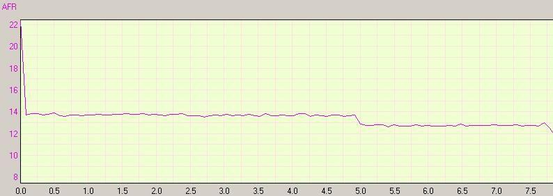

It is essentially a V-AFC with a WBO2 input and much finer resolution of MAP correction at every 100 RPMs. Basically, it is overkill. Here is an output of my WBO2 log from about 3K to redlne (on the street). I intentionally set a stair step in target AFR to see how quickly and smoothly it would make the transition. I didn't expect it to do it this well.

the curve looks smoother because the X-axis on the plot is stretched out
the VAFC controls VTEC switch which no one mentioned that gives you more power at earlier rpm
Which X axis is stretched out? The variation in AFR is only about +/- 0.25 points. The variation on a stock curve is about 2 full points.
I'm not sure what you meant about the VTEC engagement, or if it was in reference to my controller, but my controller does do VTEC engagement as well.

Now I see what you are talking about regarding the X-axis being stretched, but notice also how stretched the Y-axis is. The AFR fluctuation is exhagerated by the scale. The 1st plot shows an AFR range of 10-20, while the 2nd shows about 12-16.

I assumed he was talking about the Y-axis being stretched. Since it has a larger range, it makes the AF curve look smoother. Still, even with the wider range you can tell that the AF ratio didn't value more than 1/4 point from your "preferred value". That's very impressive considering that the VAFC varied as much as a full point (specifically around 6000-6500 RPM).

Think about it ... stretching the X-axis does make a horizontal wave look flatter. It is true that the 2nd plot is stretched some. However, stretching the Y-axis makes a horizontal wave look LESS flat. If the X-axis is stretched by the same amount as the Y-axis, the wave looks unchanged. In my 2nd plot, the Y-axis is stretched more than the X-axis, so it really looks LESS flat than it would if it wasn't stretched at all.
Basically, the 1st plot is a scanned in printout, and the 2nd plot is a screen print. What I need to do is put both plots on the same screen shot, but I can't find the Dynojet run viewer on DynoJet's web site.
MXT_77, you have my dyno run files, right? Would you put those 2 pulls on the same plot and post it?
