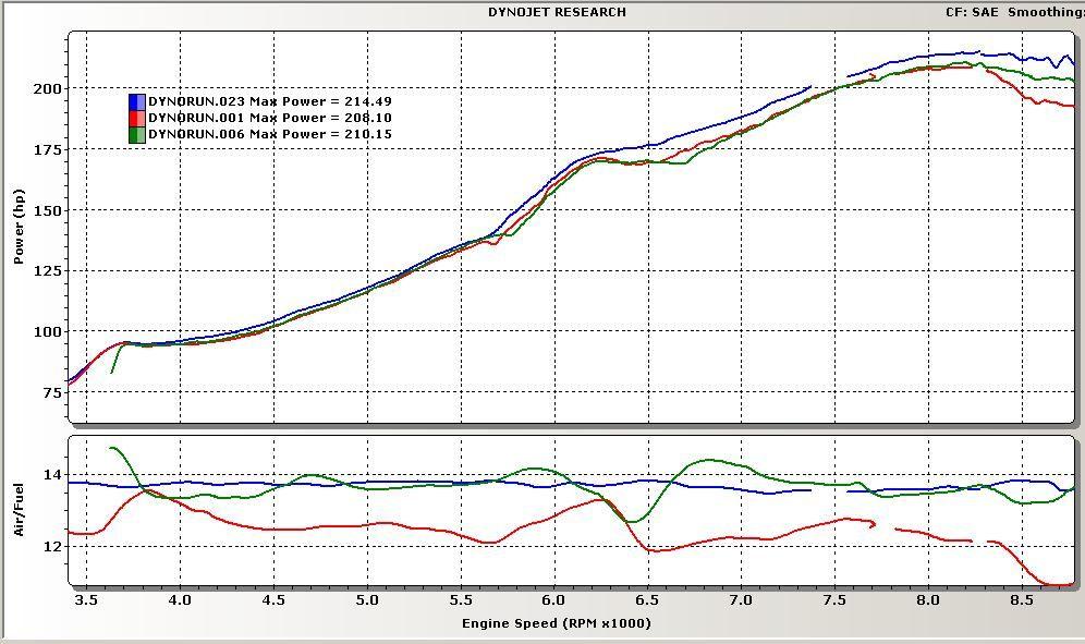

When I was talking about the Y-axis being stretched, I was actually looking at the WB02 graph, where the range goes from 8-22, compared to your other post that goes from 12-16. So, the WB02 graph should look flatter.

I finally downloaded the DynoJet Runviewer, so I created a new plot of my engine before tuning my V-AFC (Red), after tuning my V-AFC (Green), then after installing the wideband AFC (Blue). I did lower my VTEC engagement before tuning the V-AFC, but that didn't have too much effect on the results.
Note that I have rescaled the AFRs.
