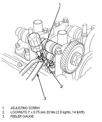

When doing a valve-adjustment I was loosening the tappet nut on cylinder #2 exhaust side and while loosening it the nut snapped off with the tappet screw. It snapped off right above the rocker.
The tappet screw and nut themselves are relativly inexpensive so that's not a worry. But would it be possible for me to replace this on my own? Do I have to dissasemble the head to replace it or is there an easier work around?

Are you saying you broke off #1 & #2 in this illustration? If so, I would try a screw extractor like the ones sold at Sears to back out the remaining portion of the adjustment screw. Unless the remaining piece is seized, it should back out. Hope this helps.

I tried that but then it seemed like it wouldn't back out anymore. After looking at this diagram (the one below) It seems like it has an edge on the bottom side of it that dosen't allow it to be backed out. That would explain why it got to a certain point that it just stopped.
Unless it should back out the whole way then I'll go take another wack at it.
As you can see in this picture I broke off number 11 half way up on number 4.
