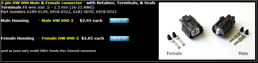

Motorcycle .090 - 2.3mm Connector and Terminals

So a buddies shop uses Findpigtails for this type of stuff. And they were super responsive. But for reference, that one connector lists for $106 and they sell it for $79. I know deep down that another honda would likely would work and most are like $10.... so may do some more digging lol. For $80 I would rather solder the damned wires to the switch, add another inline connector and heat shrink it lol!
