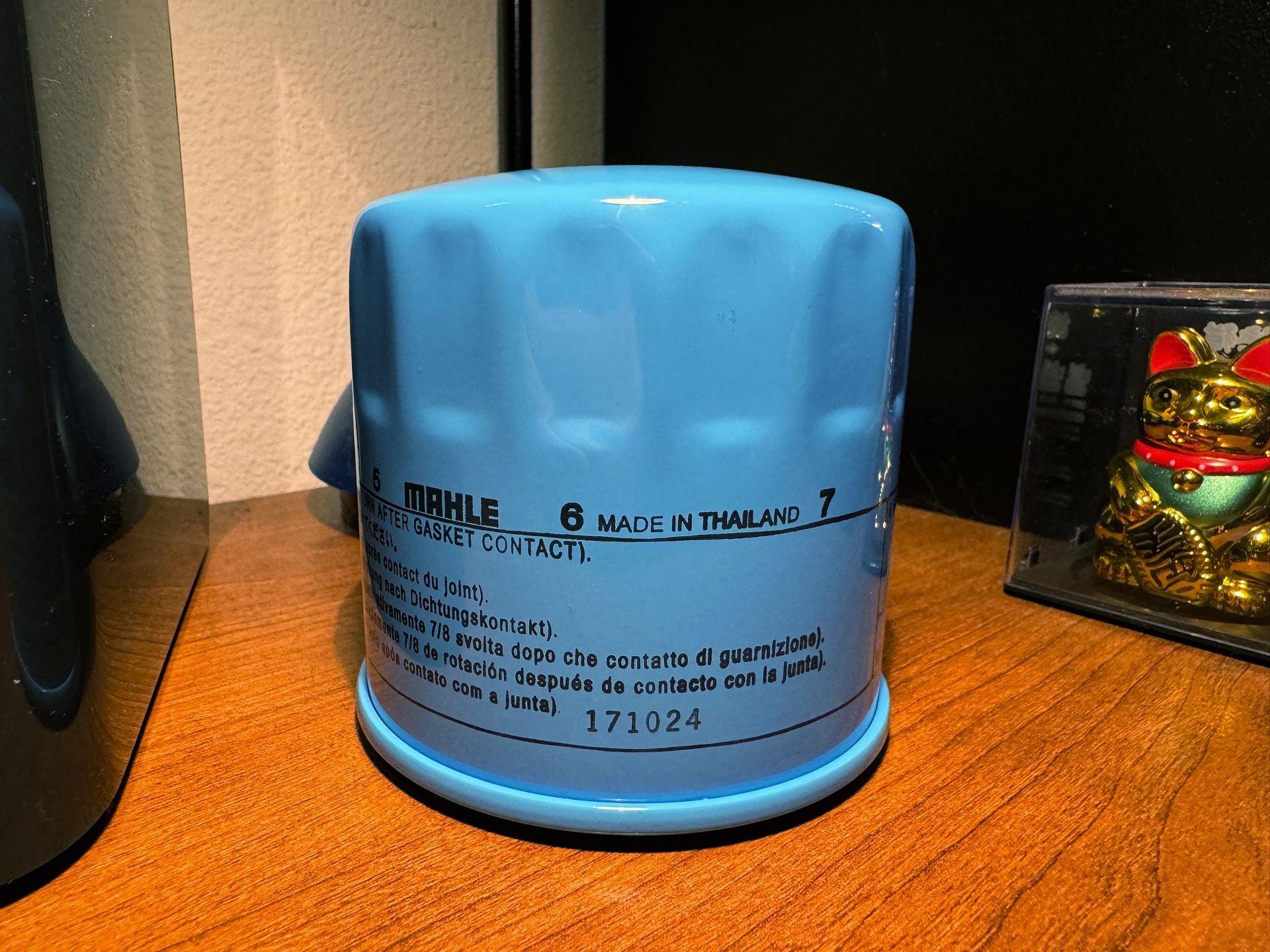

Just got back from the dealership. Informed them about the potential slag found in these filters (mainly the ones with the 18XXXX batch number) and they showed me the last two they had in stock which have the number 171024. I decided to pick one up for scientific purposes and to possibly replace the 180125 I have installed right now.
17 Series Filter
17 Series Filter

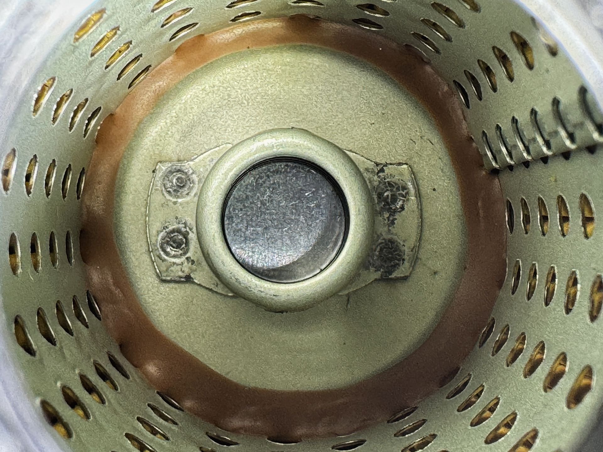

Here is what the inside looks like. I'm not noticing any teardrop slag like in OP's filters but I'm not 100% certain either. Does it look safe to install?
17 Series Filter Inside

Also, like OP said, it seems these six digit batch numbers could be the date of manufacture, so the one I have currently installed would be Jan 18, 2025, the one I just picked up would be Oct 17, 2024. So maybe go by the month or year of manufacture instead of the first two digits? Just not sure when the BXXXX filters were made though.

ISO 8601 Standard for dates is Year Month Day so the 171024 code would be 2017-Oct-24 but none of these B-markings including the one on the old dark blue filter make date-sense. October 2017 may predate the new filter.
At least this is a fun game!
-- Chuck
