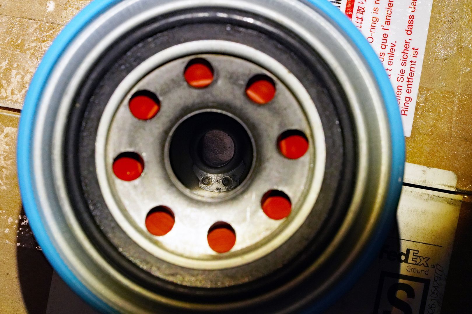

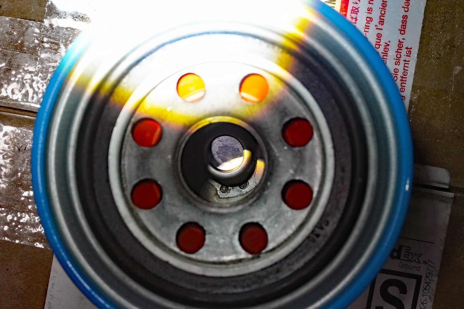

Got a pair of "306" oil filters from a dealership. No loose metal pieces that I could find.

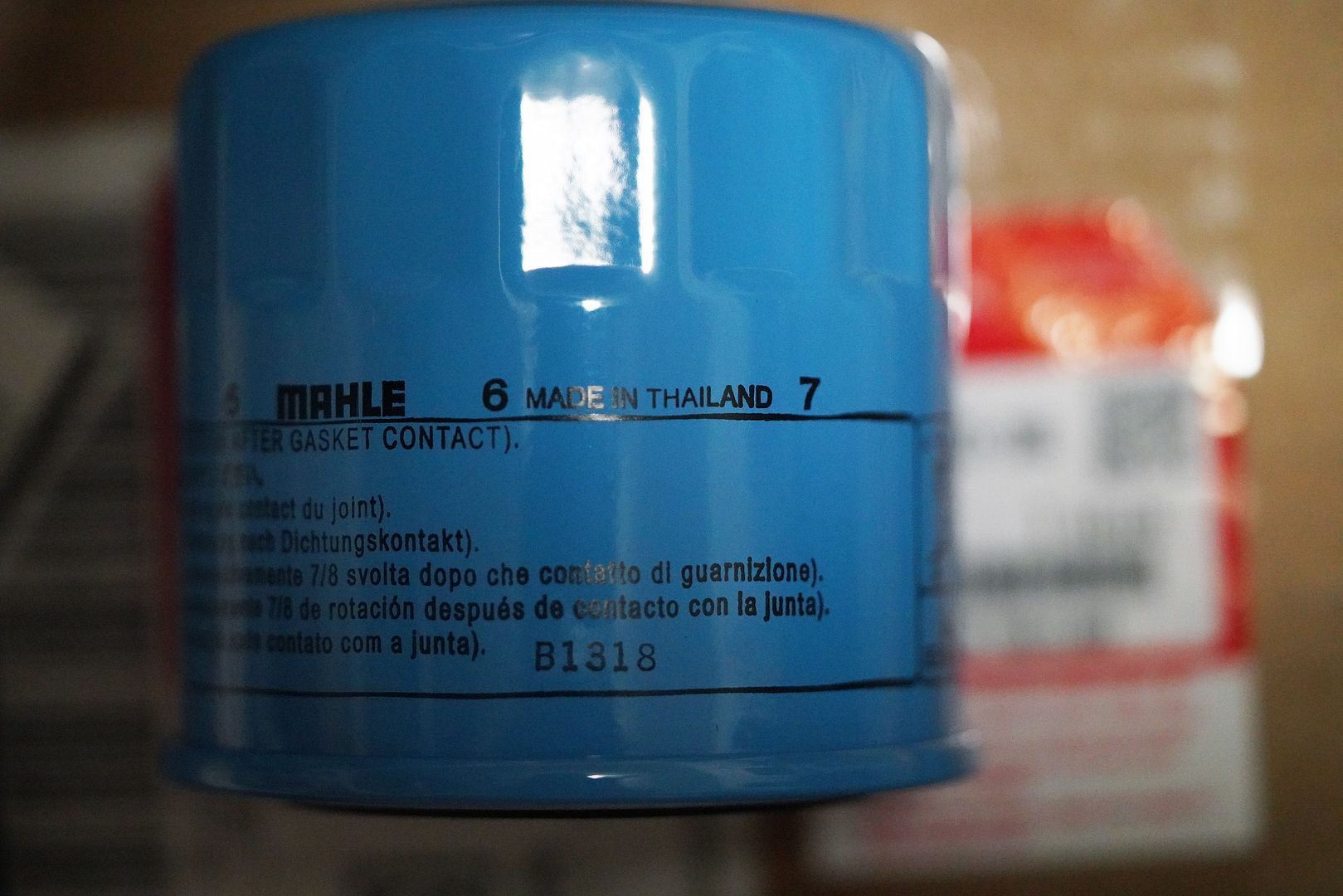

Good news! Both Lot B1318?
-- Chuck
Yes!
