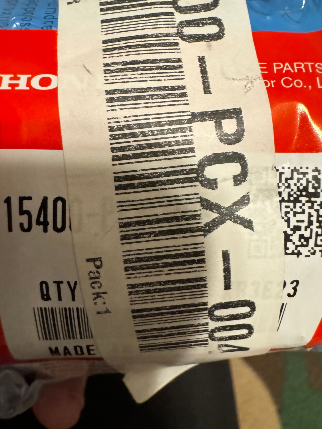

Originally Posted by windhund116
Thanks for this post. This is disconcerting, for sure. I guess that I'd better look for the older "004's" to stockpile.
I have tried that. Do not waste your time nor money from any seller on ebay or amazon selling the “004” filter. I bought a case from an amazon seller and was told that they were indeed 004 filters but when I received them they were the 306 filter with a sticker over the label that had the 004 part # on it. I did get my money back but its not worth the trouble as Im positive all of the old inventory of 004 filters has dried up. I dont blame the seller as they probably had this label on there as it was a superseded part number and to state it was the “same” filter as 306.

Originally Posted by S2k1185
I have tried that. Do not waste your time nor money from any seller on ebay or amazon selling the “004” filter. I bought a case from an amazon seller and was told that they were indeed 004 filters but when I received them they were the 306 filter with a sticker over the label that had the 004 part # on it..
UGH! Prolly the real "004" are going to go for NOS prices, now. I have a few left.
"306" on the left and "004" on the right.
