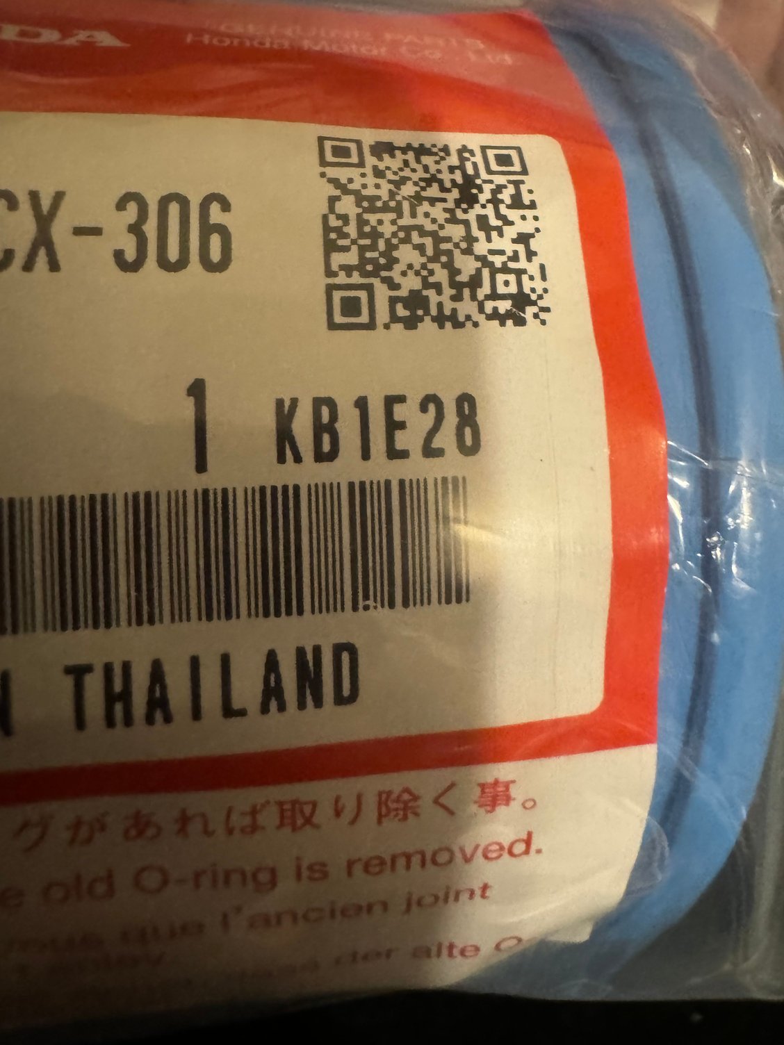

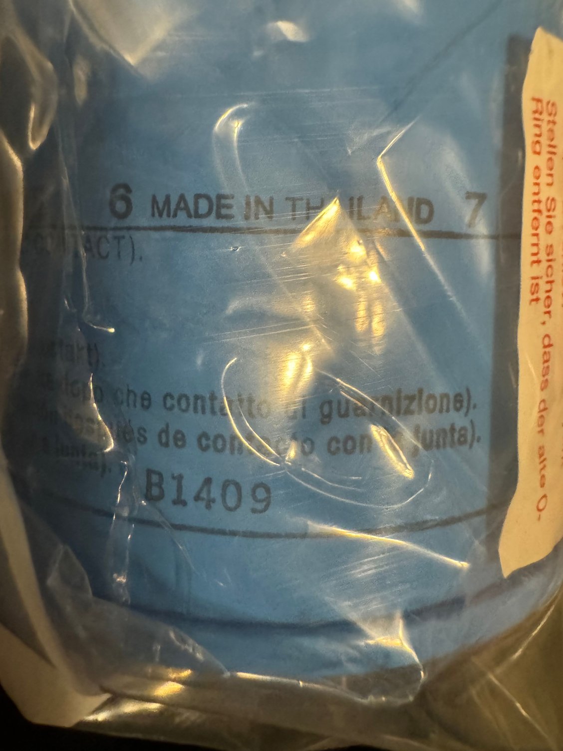

Originally Posted by S2k1185
Ireally hope this was a bad run and doesnt continue. I dont mean to have people freaking out over previous filters they used, but I thought It would be good for everyone to be aware of for the future.
Even if such incidents wind up being limited to only those few filters that you purchased, you would have no way of knowing without bringing it up here. It is far better to raise awareness among the S2KI community rather than simply ignoring such matters. The rest of us might be out the little bit of additional time it takes to inspect each filter, but that sure beats any potential downsides. I’ve honestly never inspected my oil filters in the past. Adding this one additional step to my routine before proceeding with an oil change isn’t a big deal. Thanks for taking the time to post up your findings.
Old Aug 12, 2025 | 01:59 PM
  #40
S2k1185's Avatar
Joined: Mar 2009
Posts: 121
Likes: 15
Originally Posted by windhund116
Maybe it's just a bad batch. These filters have batch numbers stamped on them. What are the batches with the slag particles?
One of the filters is “B1Z22” and the other is “B1409”. I have the others too but I will have to dig them out. The labels also have a date code as well. At least thats what I was told by an employee at a dealership. Filter “B1409” has “KB1E28” on the Honda part # sticker. “B1Z22” had “KB2D19” on its label.
